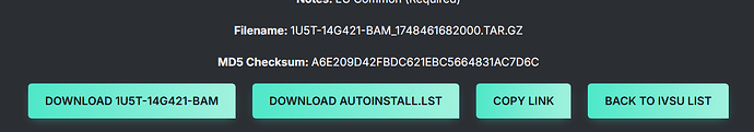

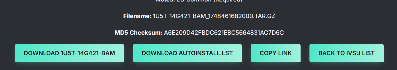

From the following list, manually re-install all one at a time. You can reuse the files there are currently on the USB, you just need to change the autoinstall.lst file on its root.
To make things easier, you can download the required autoinstall.lst file from the links for each file:
So you can download all autoinstall.lst files and you just have to change it for each file.
