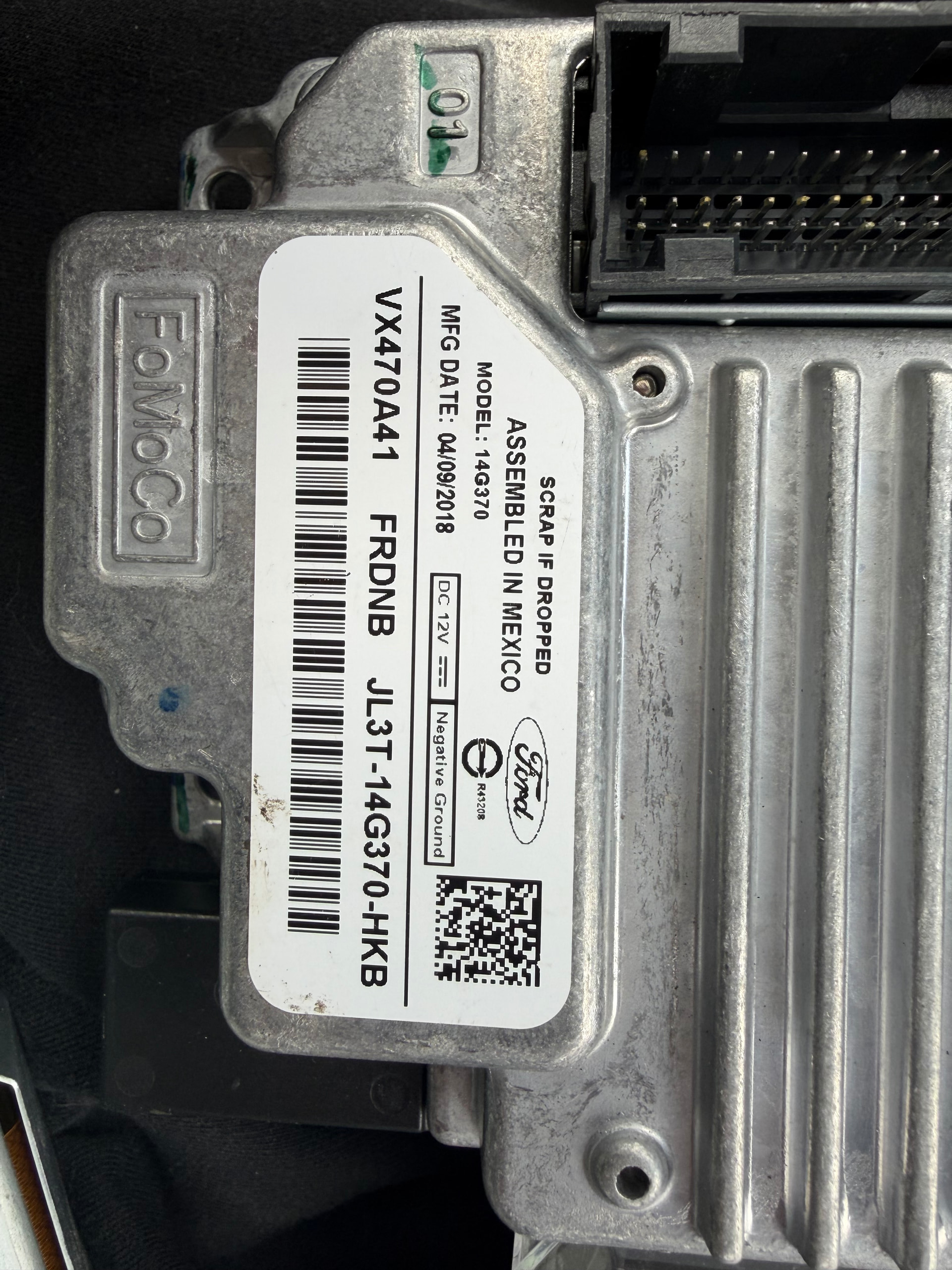

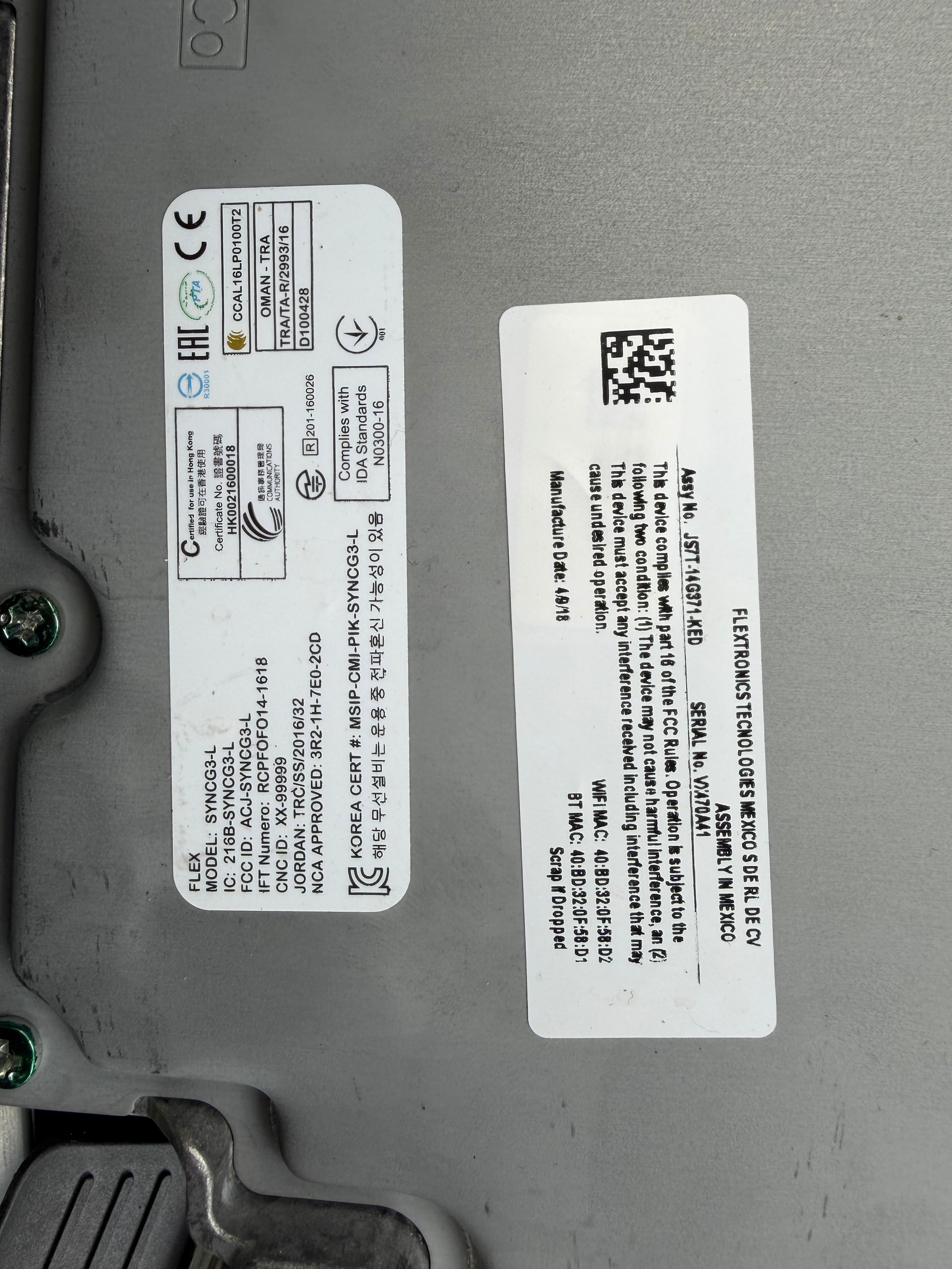

I can try to check tomorrow, but all I know is the screen went dark on my buddy while he was driving so I gave my him old apim as my other vehicle was totalled, I do know the apim is a j series model which is one I have been looking for
Part number is on the back of the APIM, the side that connects to the screen. So you have to take the screen off to see it. Take a pic of the back of the APIM and post it here…
Ight, I’ll post that pn tomorrow
Not a 2020+
Thought so
