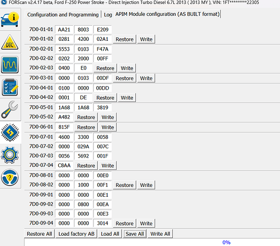

OK, I have been Forscan programing this Sync 3 retrofit now for the last few days and I think I may have it all figured out except for the Nav input while in motion.
I’ve tried every combination in the DRPE in 7D0-09-xxxx-xxxx-*xxx in the AB APIM database. Does this mean that my vehicle/system is not capable of this feature? I attached my current AB for my 2013 F250, if someone wouldn’t mind checking my work.
Thanks so much for the help
