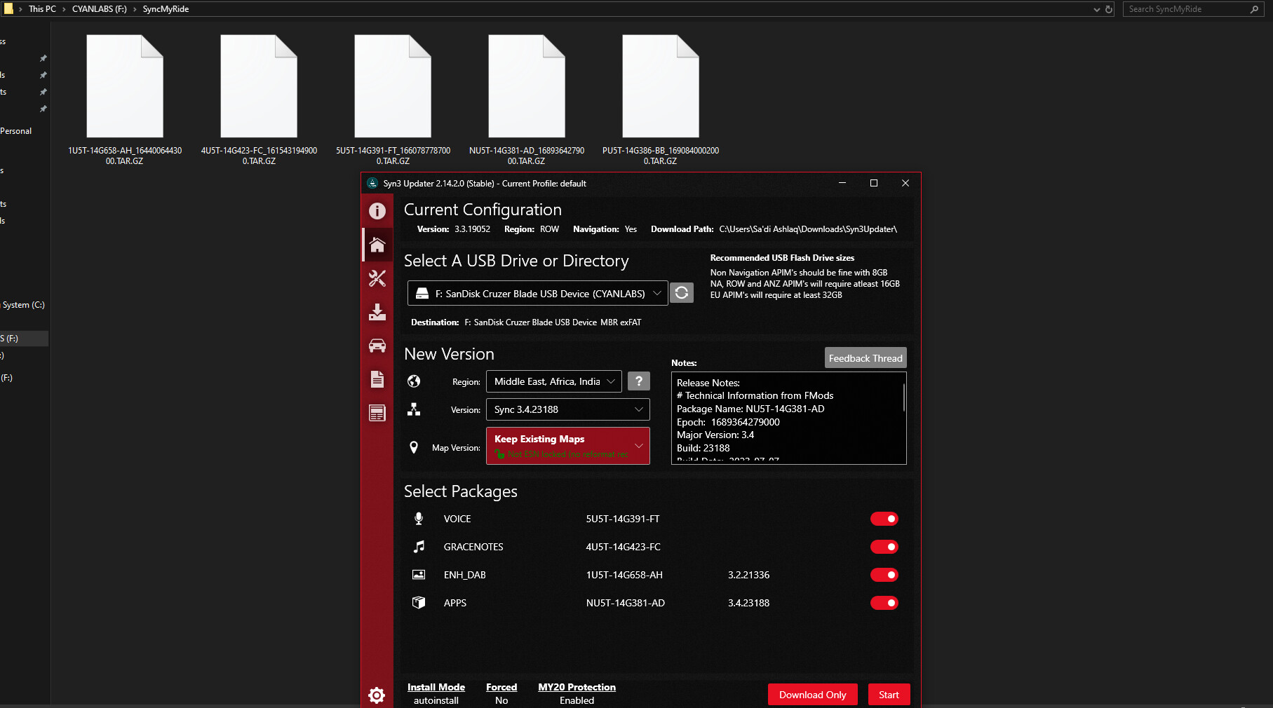

I have an ford Fusion 2017 sync 3 with version 3.3.19051, and I installed the LTS 3.4.23188. When I plug in the USB, it gives me a message saying there is an update, etc. I press Yes to proceed, but after pressing Yes, nothing happens, and there is no notification saying that the update is processing.
SYNC Region: ROW
Old SYNC Version: 3.3.19051
Syn3 Updater Version: Syn3 Updater

Remove the rw cleaner tool from the installation.
ashlaq
(ashlaq)
27 November 2025 18:31
4
Should I remove this file from the USB: PU5T-14G386-BB_1690840002000.TAR.GZ
Because this one isn’t showing in the app to turn off or remove.
F150Chief
(F150Chief)
28 November 2025 07:54
5
Uncheck the asset in the app.
ashlaq
(ashlaq)
28 November 2025 09:42
6
Bro, I didn’t get it. The RWDataCleaner tool isn’t showing, so I’m not able to uncheck it. What exactly should I uncheck from the screenshot
F150Chief
(F150Chief)
28 November 2025 17:54
7
Edit the autoinstall.lst file to this, removing the cleaner file…
Item1 = VOICE - 5U5T-14G391-FT_1660787787000.TAR.GZ
Open1 = SyncMyRide\5U5T-14G391-FT_1660787787000.TAR.GZ
Item2 = GRACENOTES - 4U5T-14G423-FC_1615431949000.TAR.GZ
Open2 = SyncMyRide\4U5T-14G423-FC_1615431949000.TAR.GZ
Item3 = ENH_DAB - 1U5T-14G658-AH_1644006443000.TAR.GZ
Open3 = SyncMyRide\1U5T-14G658-AH_1644006443000.TAR.GZ
Item4 = APPS - NU5T-14G381-AD_1689364279000.TAR.GZ
Open4 = SyncMyRide\NU5T-14G381-AD_1689364279000.TAR.GZ

and gives me this error with red screen: error 4U5T-14G423-FC_1615431949000.TAR.GZ
F150Chief
(F150Chief)
30 November 2025 17:57
9
Don’t override the install mode. This won’t work with reformat.
