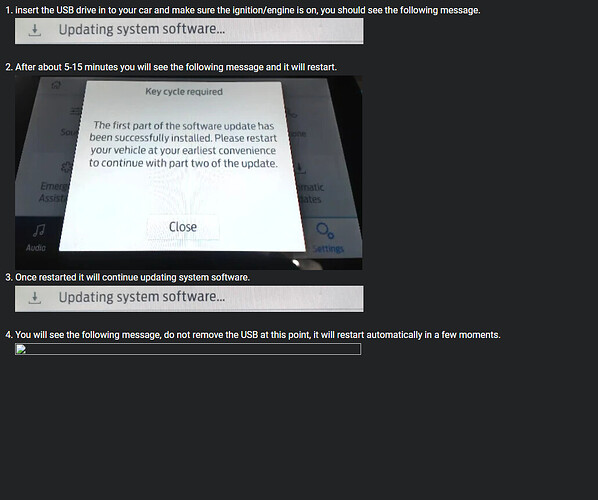

It seems you interrupted the process, you should read the instructions to avoid such issues → Install Modes - CyanLabs
Keep the USB connected until the tutorial says it’s safe to remove it.
If this is truly how you set up the software then you got what you asked for.
That’s another mistake he made while manually completing the template, the USB was created for 3.4.23188…

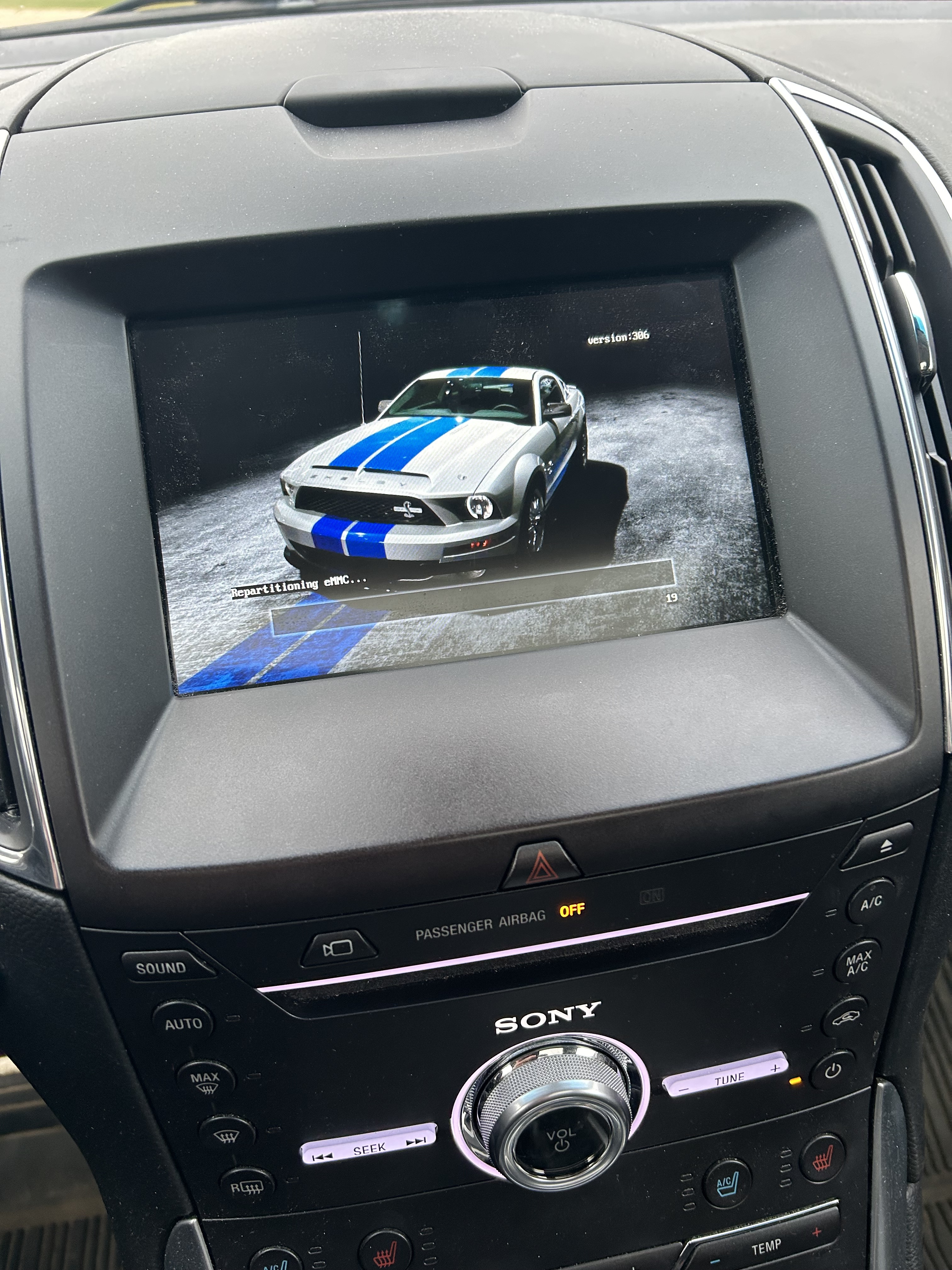

Thanks I will go back and reinstall. I pulled the USB when I was prompted, obviously reading your reply I see this should not be done. The pic in section 4 was not visible on my end for whatever reason. Anyhow should I redo the syn3 upgrader and USB with the 3.3.19052 to 3.4. 23188 files or just re-insert this same USB and let it continue?
Just re-plug your current USB, it will work…

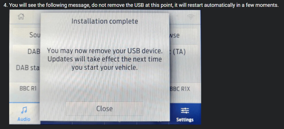

The image for #4 is not important, since the text tells you the unit will reboot.
But, here it’s:
Thanks for your quick reply.
All set then, remember to perform a master reset once it’s done.
