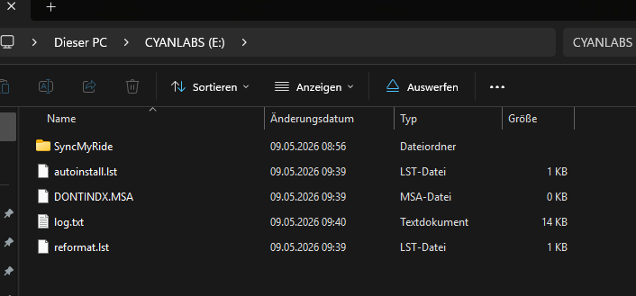

i tried to reformat and update my maps for sync3

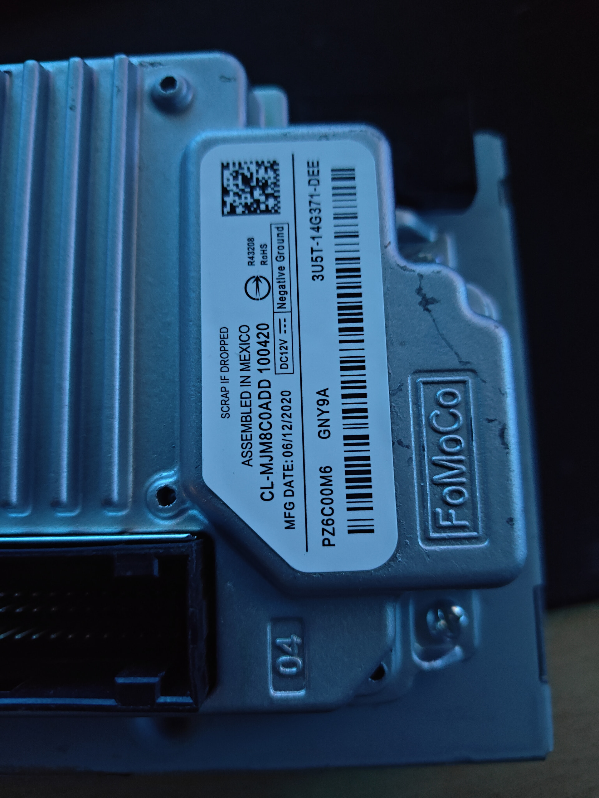

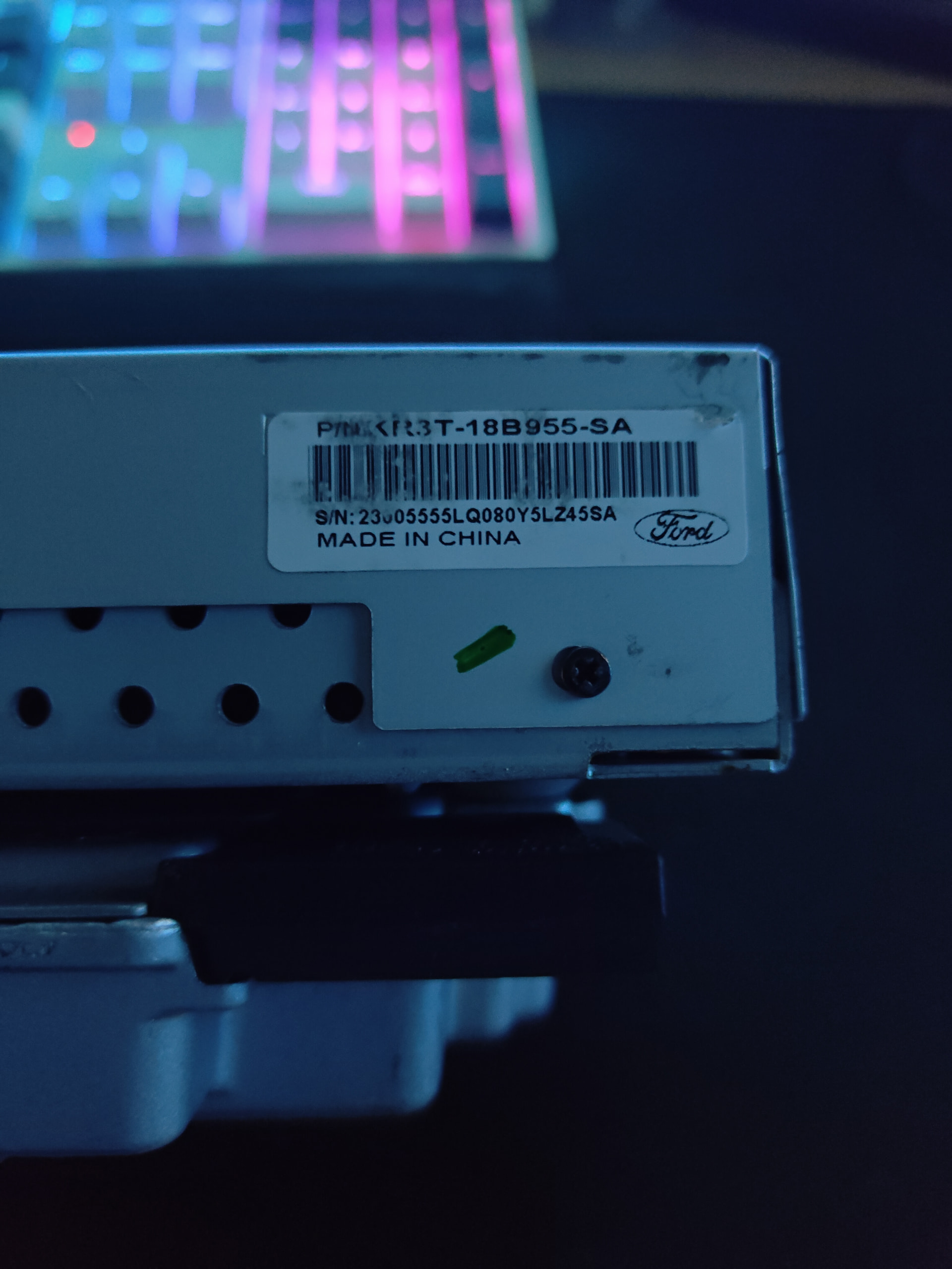

i retrofitted the sync3 from an 2018 ecosport to my focus from 2015, which had sync2
i also did the interrogator to be sure its not my20 unit
i put the car on battery charger, turned on ignition and plugged in the usb stick
it started the update, then it restarted to apparently an older sync3 version (looked different)
then it said usb port not supported or silimar and said it will update, then it restarted and then it was a black screen
i let it run for a while (20minutes, but nothing happened)
i turned off the ignition, closed the doors, locked, waited, unlocked and turned ignition back on and waited again. but still black screen
i tried plugging in another usb that lights up when detected but it didnt light up, also i tried plugging my phone in with an usb c cable to see if there is power, but nope
is it dead? why?
any way to get it back working? i literally just got it and wanted to clean flash it and then mod it :frowning:

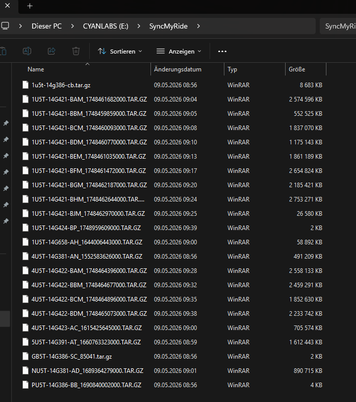

MAP=1U5T-14G421-BAM_1748461682000.TAR.GZ
MAP=1U5T-14G421-BBM_1748459859000.TAR.GZ
MAP=1U5T-14G421-BCM_1748460093000.TAR.GZ
MAP=1U5T-14G421-BDM_1748460770000.TAR.GZ
MAP=1U5T-14G421-BEM_1748461035000.TAR.GZ
MAP=1U5T-14G421-BFM_1748461472000.TAR.GZ
MAP=1U5T-14G421-BGM_1748462187000.TAR.GZ
MAP=1U5T-14G421-BHM_1748462644000.TAR.GZ
MAP=1U5T-14G421-BJM_1748462970000.TAR.GZ
VOICE_NAV=4U5T-14G422-BAM_1748464396000.TAR.GZ
VOICE_NAV=4U5T-14G422-BBM_1748464677000.TAR.GZ
VOICE_NAV=4U5T-14G422-BCM_1748464896000.TAR.GZ
VOICE_NAV=4U5T-14G422-BDM_1748465073000.TAR.GZ
MAP_LICENSE=1U5T-14G424-BP_1748959609000.TAR.GZ
; CyanLabs Syn3Updater 2.14.2.0 Stable - downgrade  Mode - Sync 3.4.23188 EU
FILES (22)
1u5t-14g386-cb.tar.gz (8,5MB)
1U5T-14G421-BAM_1748461682000.TAR.GZ (2,5GB)
1U5T-14G421-BBM_1748459859000.TAR.GZ (539,6MB)
1U5T-14G421-BCM_1748460093000.TAR.GZ (1,8GB)
1U5T-14G421-BDM_1748460770000.TAR.GZ (1,1GB)
1U5T-14G421-BEM_1748461035000.TAR.GZ (1,8GB)
1U5T-14G421-BFM_1748461472000.TAR.GZ (2,5GB)
1U5T-14G421-BGM_1748462187000.TAR.GZ (2,1GB)
1U5T-14G421-BHM_1748462644000.TAR.GZ (2,6GB)
1U5T-14G421-BJM_1748462970000.TAR.GZ (26MB)
4U5T-14G422-BAM_1748464396000.TAR.GZ (2,4GB)
4U5T-14G422-BBM_1748464677000.TAR.GZ (2,3GB)
4U5T-14G422-BCM_1748464896000.TAR.GZ (1,8GB)
4U5T-14G422-BDM_1748465073000.TAR.GZ (2,1GB)
1U5T-14G424-BP_1748959609000.TAR.GZ (1,7KB)
[09.05.2026 08:55:06] Selected Region: EU - Release: Sync 3.4.23188 - Map Version: F13 (2024) - EU (09 2025)
[09.05.2026 08:55:06] Install Mode: Auto-Detect (downgrade) Forced: False
[09.05.2026 08:55:06] MY20 Protection: Disabled / Not MY20
[09.05.2026 08:55:06] Formatting USB drive

my usb stick folders
i also use a usb c/usb a hub from sync3

i just reverted back to my old Sync2 unit and saw whats on the screen frame…
serial number: KR3T-18B955-SA
so the seller quacked me over and sold me a frankenstein build. i messaged him already and waiting for updates. oh boy…
edit: could i use an pre 2020 screen to finish the install/reformat?

As per por APIM, I would like to see the sticker.
I’m sorry, wont happen again. Thank you.
Only backlight is there, no audio or anything. No power on usb hub, either sync3 one or sync2 one (I tested). When I plugged in the USB to update, it started fine, then went into the older UI (3.3 ?) and it did updating from there. The Touch and audio still worked there. Then I got a pop up that the hub is not recommended or something like that, then I clicked ok, then the top line said installing update, then the screen went black and well, yes, now its like that. The hub doesnt provide power. I wrote the seller about this missmatch and if he cant fix it, I will need to return it. Since its a mix and match of parts. My assumption is, that the APIM is fine, just the screen is MY20? And its missing drivers and halting the whole install? I never touched Sync3 that much. I just wanted to update my maps to latest and do a fresh install. Interrogator showed that its a pre MY20 unit, so I didnt think much about the screen. Well, now I know…
Pictures attached:
Thank you for the pictures.
What you are describing is a typical scenario of reformatting a MY20 unit.
The sticker you sent says it’s MY20, but I would say that APIM is a counterfeit.
The model on the sticker does not correspond to what the interrogator you sent before says.
So no one can assure what the unit actually is.
About APIM JK2T-14G371-BCC I can’t assure if it’s MY20 or not, maybe others can. But what’s happened points to yes, but that does not explain why the sticker does not match.
Your best course would be to try returning the APIM since it’s been modified, we know that based on the sticker. If it’s a MY20 unit it can be revived, but you need to have some knowledge and open the APIM.
So if a return is possible, it will surely be easier.
