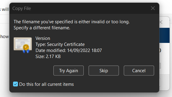

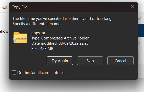

i get this error when trying the files to extract to a USB
Dont extract, just copy it. Also dont rename the file.
I’ll try that later appreciate it
