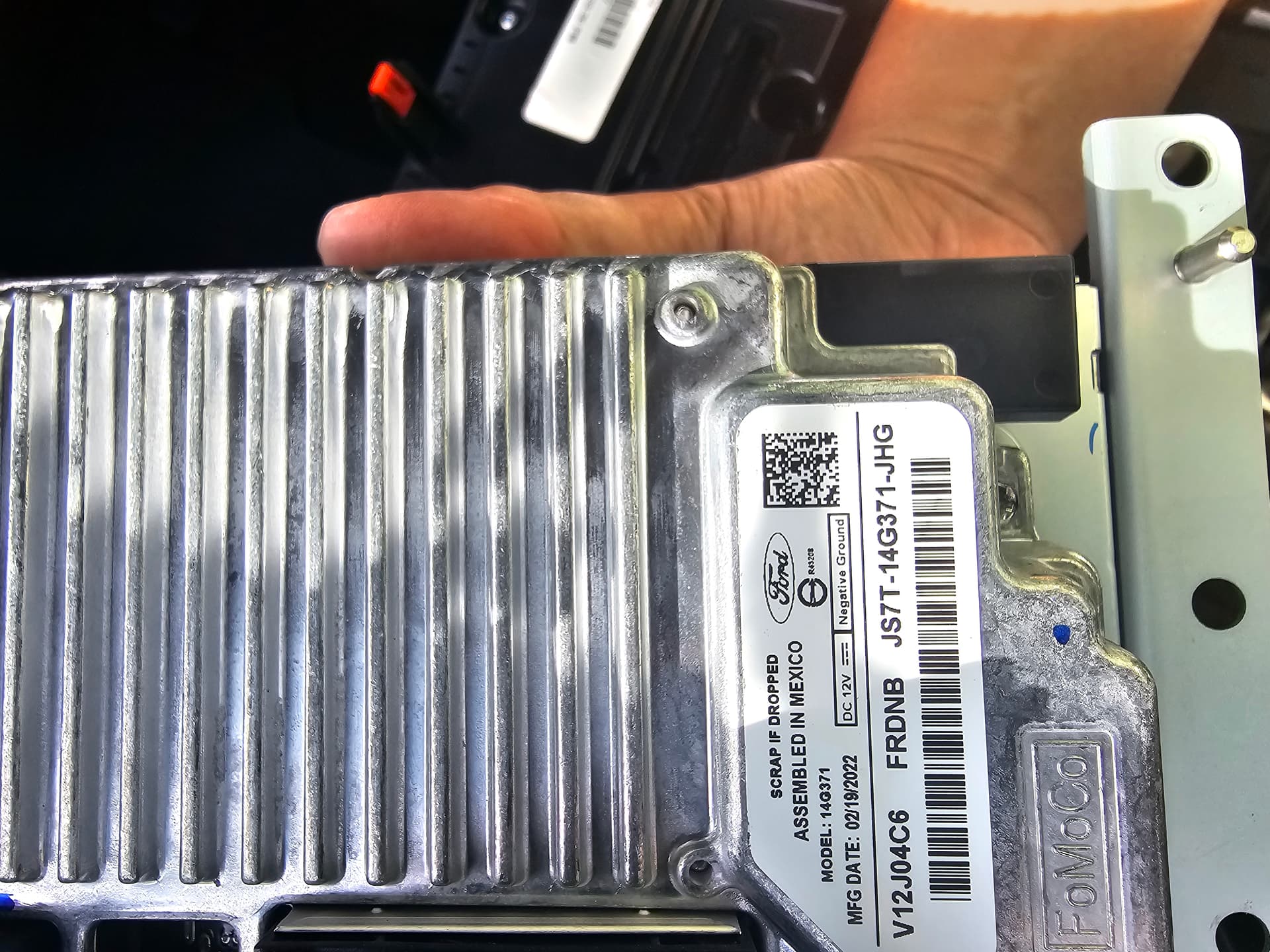

You will need to unmount the unit, take a picture of the unit’s sticker and share it with us.
That APIM is not flagged as MY20, but it’s a new APIM and we do not have a lot of information about it.

I just open up and noticed that my apim has a manufacturer’s date of 02/19/2022. Guess that’s why it bricked. Anyway to recover?

Here is another picture of the whole apim. I also tried this link to rescue my apim. APIM Firmware Flash Rescue
