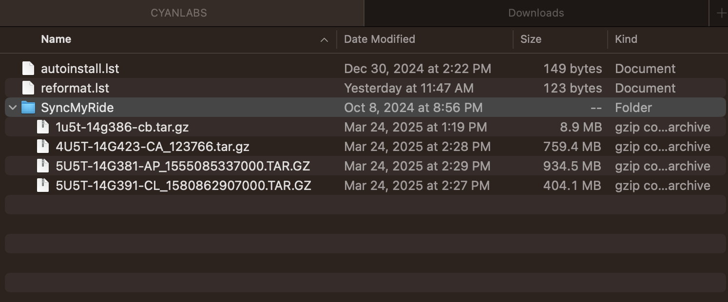

Sorry My current Sync version is 3.4.20198. My usb files look like this.
I noticed in your example the 1u5t-14g386-cb.tar.gz is not there.

For the whole procedure you need to include the files listed in the autoinstall and reformat files attached. You can place both of these files in the root of the USB.
autoinstall.lst (563 Bytes)
reformat.lst (657 Bytes)
The autoinstall.lst file contents:
; Reformat Mode - Sync 3.4 Downgrade
[SYNCGen3.0_3.4.23188_PRODUCT]
Item1 = PU5T-14G386-BB_1690840002000.TAR.GZ
[SYNCGen3.0_3.4.23188]
Item1 = GB5T-14G386-SC_85041.TAR.GZ
Open1 = SyncMyRide\GB5T-14G386-SC_85041.TAR.GZ
Item2 = 4U5T-14G381-AN_1552583626000.TAR.GZ
Open2 = SyncMyRide\4U5T-14G381-AN_1552583626000.TAR.GZ
Item1 = 1U5T-14G386-CB.TAR.GZ
Open1 = SyncMyRide\1U5T-14G386-CB.TAR.GZ
The reformat.lst file contents:
So, for the autoinstall file, there are 4 files to be placed in the SyncMyRide folder on the USB:
So, for the reformat file, there are 15 files to be placed in the SyncMyRide folder on the USB:
This is 19 files total in the SyncMyRide folder on the USB:
NOTE: The filenames in the autoinstall and reformat files must match exacly the files contained in the SyncMyRide folder on the USB:
