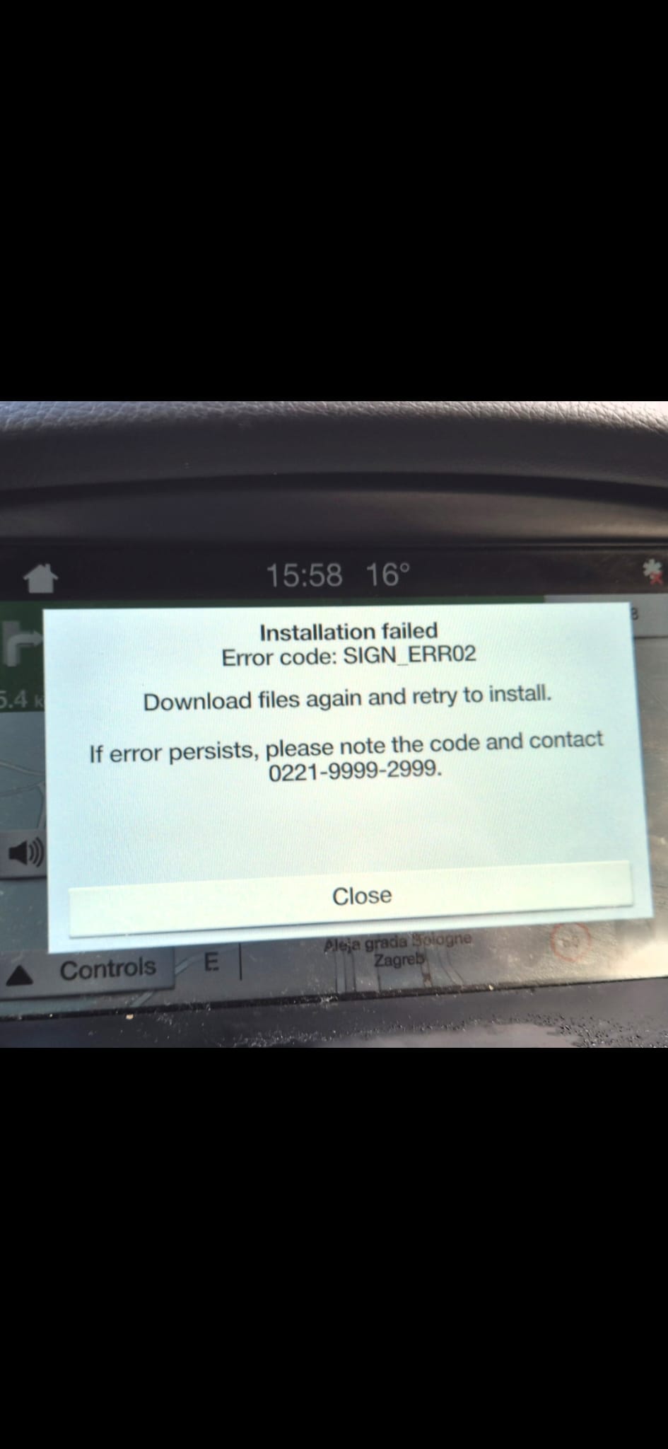

Yesterday I made USB with sy3Updater and have tried to upgrade to v. 3.4.23188.
In Maps v. I chose “Keep existing Maps”.
During instalation I received next error:
On Forum I see:
Signature Errors (Issues caused by invalid Version.der files)
SIGN_ERR02 – Error is SIGN_HASH_VALUE_MISMATCH
but how can I solve this?
Thanks
License file error. We would need to see the installation log file to know anything…
Can you see something from this log?
log.txt (4.7 KB)
That one is the log for the Sync 3.4.23188 installation. Don’t use the PU5T-14G386-BB_1690840002000.TAR.GZ file, it is not needed and likely throwing a sign error when used on Sync 3.3.
Use the Syn3 Updater to generate a new installation autoinstall.lst file or edit the autoinstall.lst to remove the file. Renumber the list to start at 1. Like this…
Item1 = VOICE - 5U5T-14G391-AT_1660763323000.TAR.GZ
Open1 = SyncMyRide\5U5T-14G391-AT_1660763323000.TAR.GZ
Item2 = GRACENOTES - 4U5T-14G423-AC_1615425645000.TAR.GZ
Open2 = SyncMyRide\4U5T-14G423-AC_1615425645000.TAR.GZ
Item3 = ENH_DAB - 1U5T-14G658-AH_1644006443000.TAR.GZ
Open3 = SyncMyRide\1U5T-14G658-AH_1644006443000.TAR.GZ
Item4 = APPS - NU5T-14G381-AD_1689364279000.TAR.GZ
Open4 = SyncMyRide\NU5T-14G381-AD_1689364279000.TAR.GZ
Many thanks… it works
