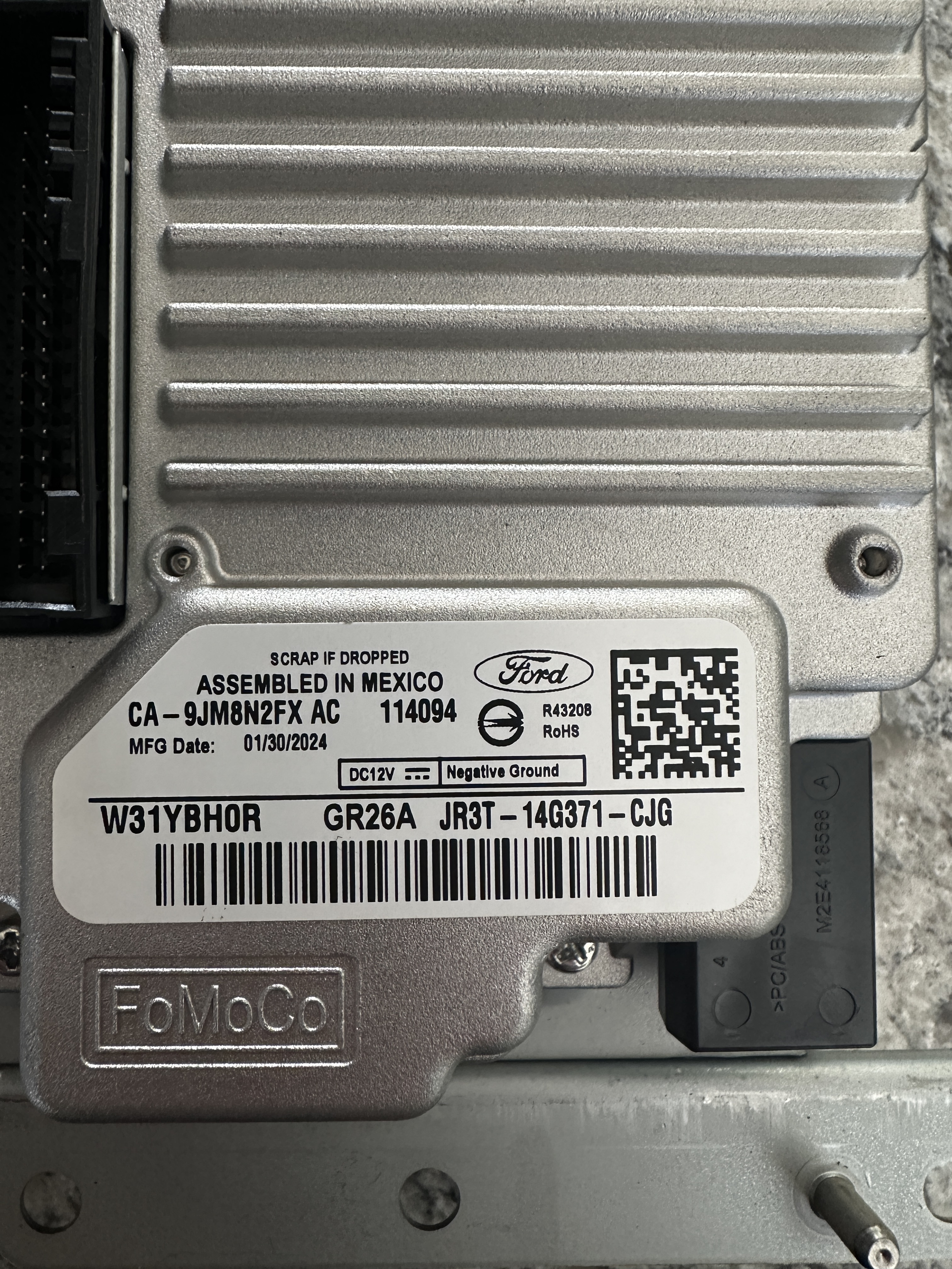

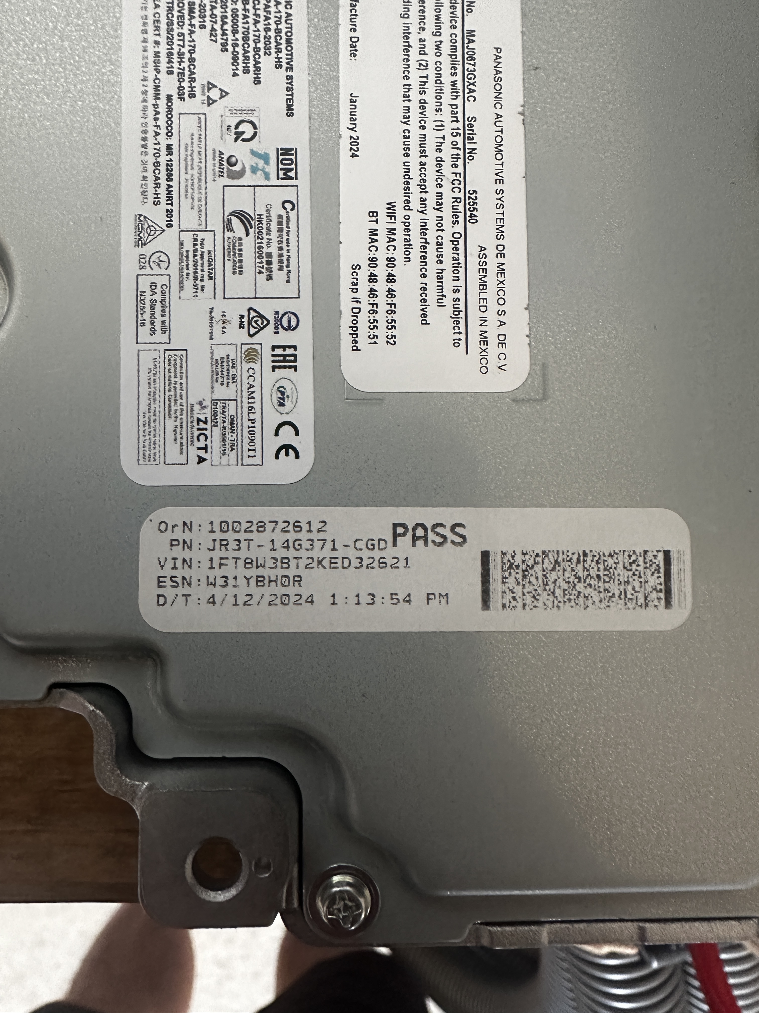

The first problem I see if that you HAVE to have a 32Gb thumb drive to install nav and you only have a 16Gb based on the info you provided. This is clearly noted in the documentation you said you read under requirements.
A 2019 K series APIM should also come with 3.4 or 3.2 at the least. You have this starting at 3.0.23219 which is something a 2017 would have in it.
No power is a totally different issue though. You need to check fuses and power to the unit if that is truly what is happening. Are you sure the screen is not on and just blacked out? What modifications have you done with Forscan? Does you ELM have a switch on it?
If it is a MY 2020+ replacement APIM than no calibrations are going to fix this. The only real way to know this is to take the unit out and look at the date on the back unless you know it was replaced at some point.
When it updated, it was still on the old sync 3.0. I didn’t even make it to the loading bar. The top said updating and ran through that, then while still on 3.0 it said the update was completed and changes would take on next vehicle start up, then before even removing the drive or shutting it down, the screen went black.
When I turn it on, black screen, the USBs will light up for around 15 seconds or so, then the USB lights shut off.

Simple question: what’s the ā€œdeadā€ APIM’s model?. (it can be read by Forscan)
Can you share a picture of the sticker on its back?.
Also, have you ever replaced the screen?. If you can, share the sticker on its back.
This unit was a 2024 Unit. Build date Jan/2024 and was appeared put in by a dealership April 12th. I bought the truck 3 weeks ago. Issue solved.
This is a 2020+ unit for sure. It’s toast now.
