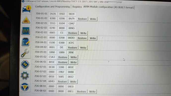

hi, guys im back i got cable and connect forscan this is the apim register, how can i know if the apim is death (bricked) or alive?

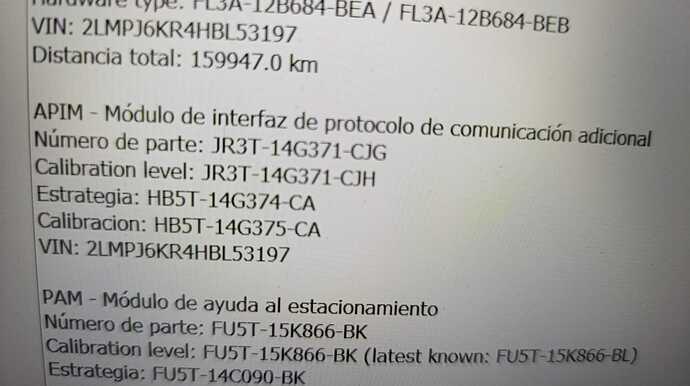

We need the APIM model, go to the modules section and check what that is.
this is the apim part number, is it the model?
Well if you got this AB info from it than it is alive.

Yes, thank you, that’s the model.
Sadly, APIM model JR3T-14G371-CJG is MY20, so you killed / bricked it by reformatting it. For future reference, keep in mind that you could have checked for that either manually in Syn3Updater, via our SYNC 3 APIM Hardware Database - CyanLabs or automatically via Syn3Updater while creating the USB pendrive.
