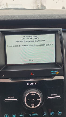

Hello. I updated from 2.3 to 3.4, changing the region from US to EU with smaller maps to fit on the APIM.

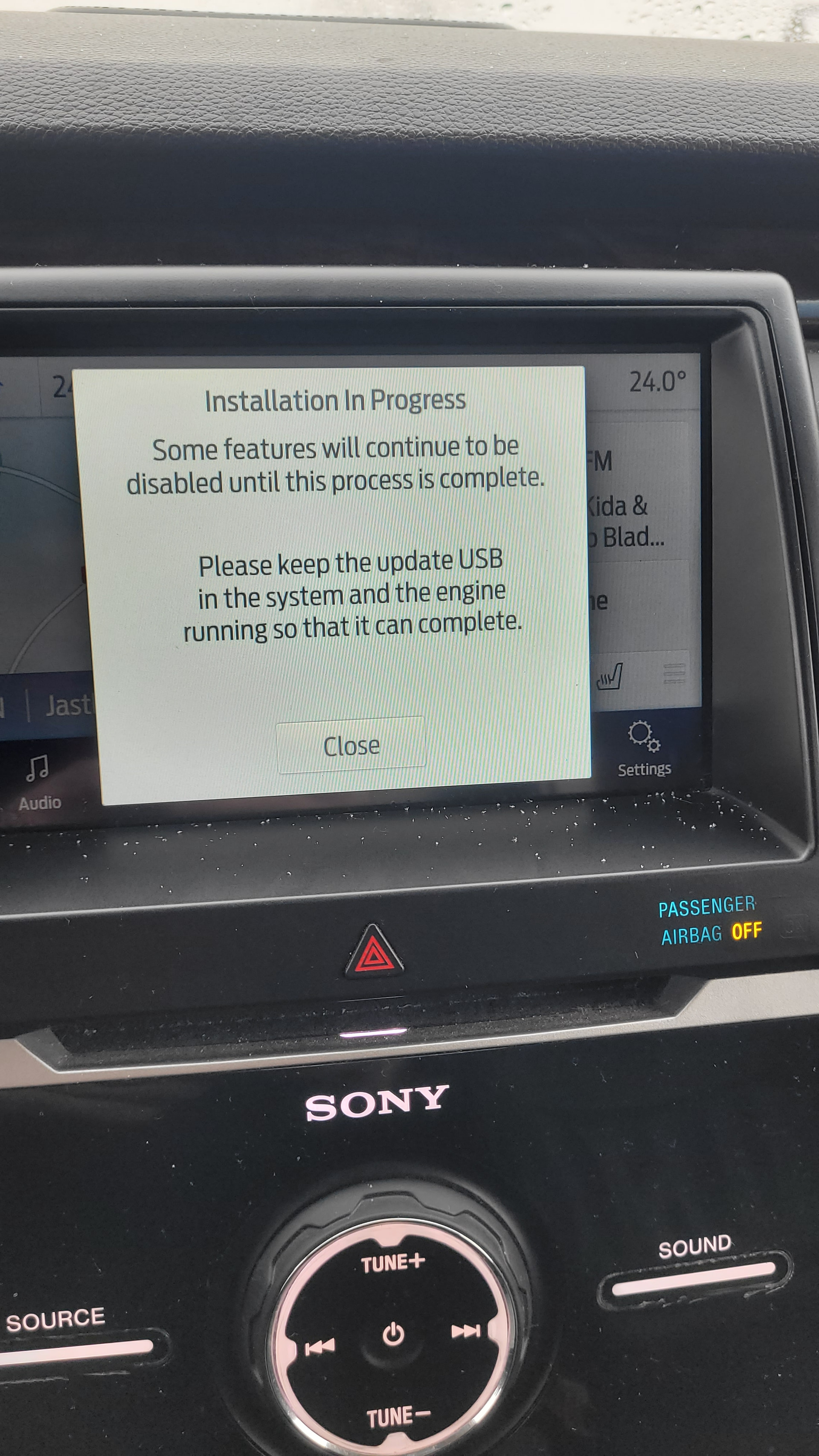

Everything went smoothly. After installing and removing the USB drive, the message shown in the picture appeared. After reconnecting the USB drive, another message appeared, as shown in the picture. Generally, everything works, but sometimes I get a message to insert the USB drive and complete the installation.
What can I do about this?
Old SYNC Version: 2.3.17109
Installation Failed Error Code PKG_ERR04 Download Files again and retry to install

Try again with a brand name USB stick as recommended many times in here.
I have used this USB stick many times for this purpose and have never had this problem before.
Well if that’s not a lifetime guarantee i don’t know what is.
Do I need to downgrade to re-upload the latest version?
