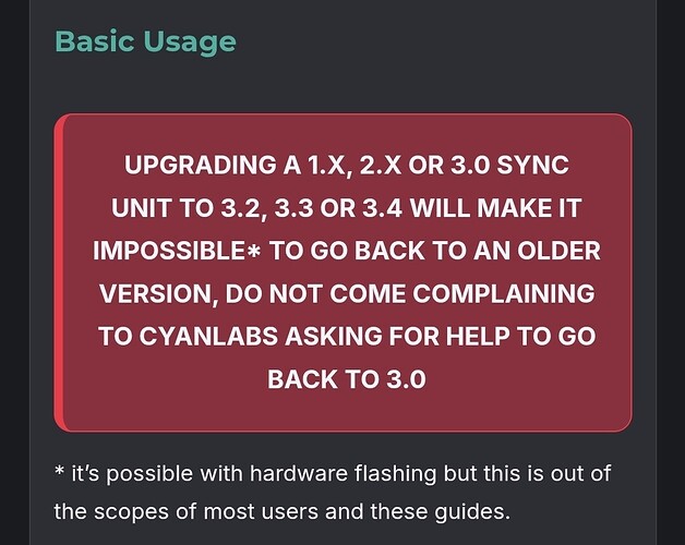

It’s clearly stated in multiple places, like in the basic guide https://cyanlabs.net/docs/syn3updater/getting-started/basic-usage/
well noted and as i said before its my fault didnt read all details and not blaming nobody or forum app or etc. My radio is working good and have no issues at least for now.
