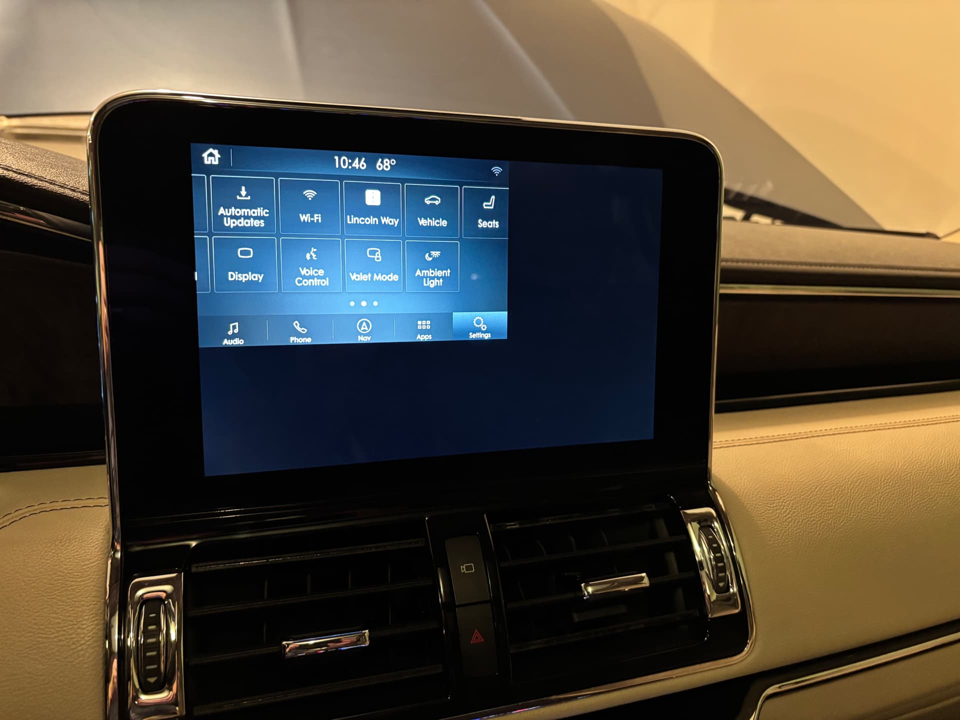

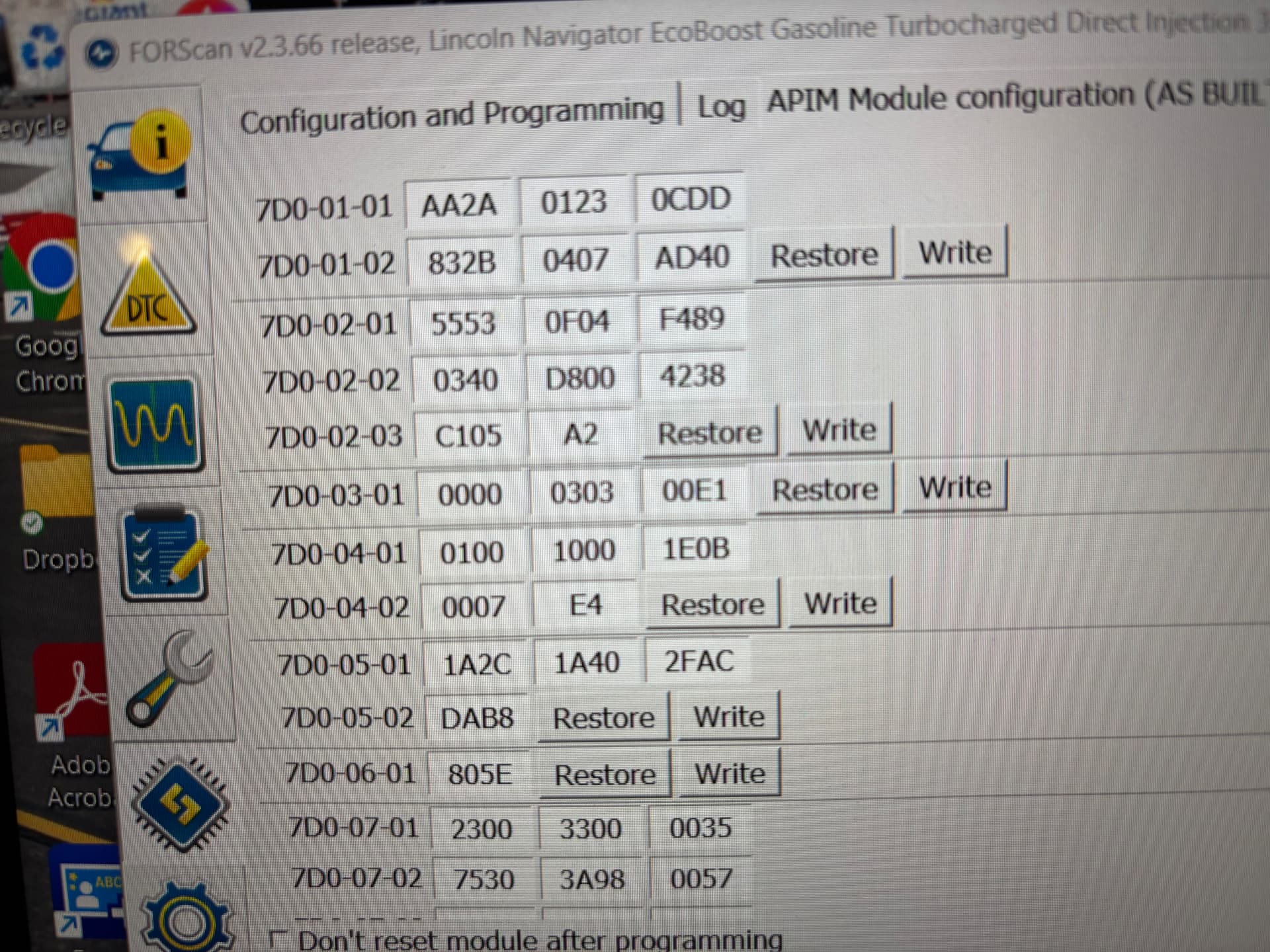

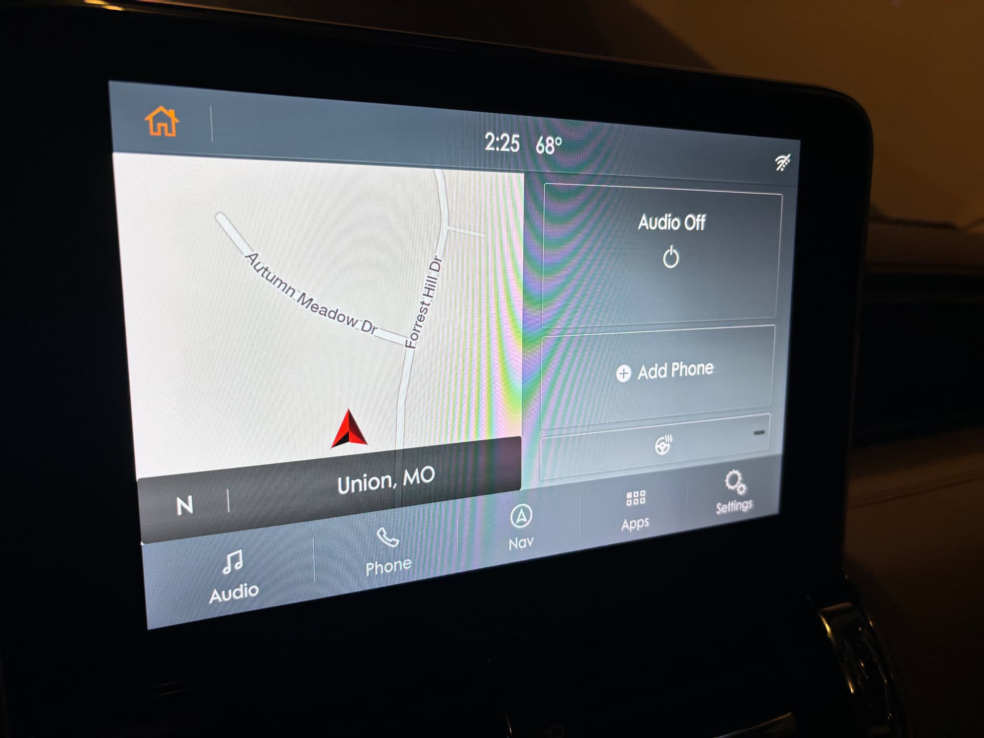

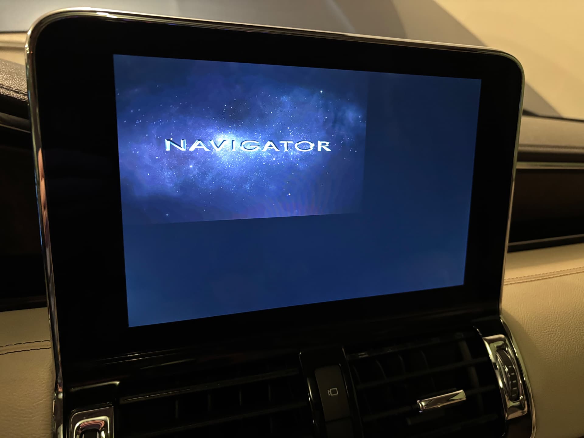

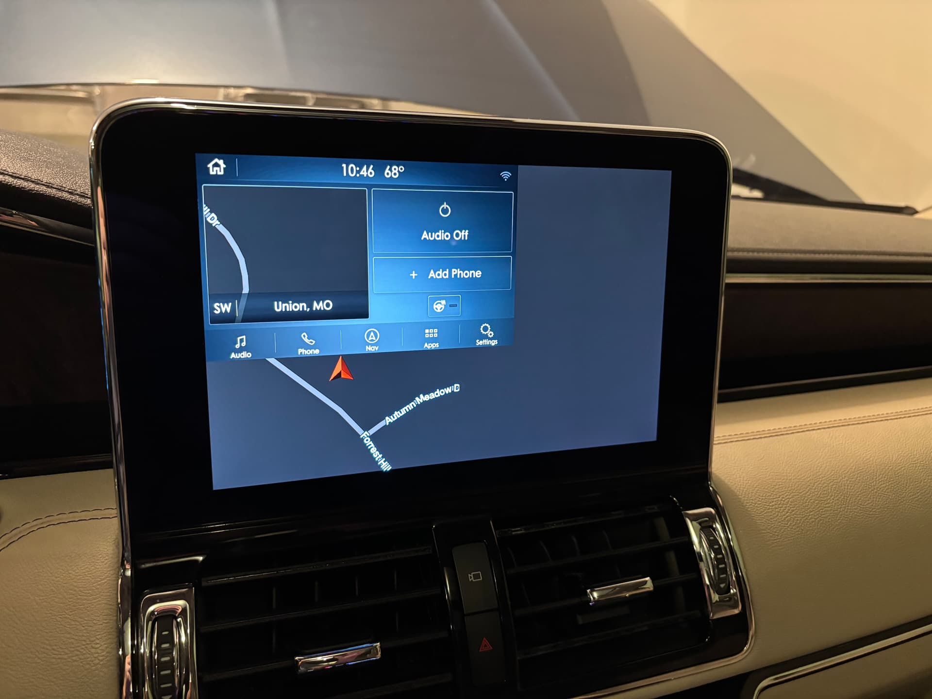

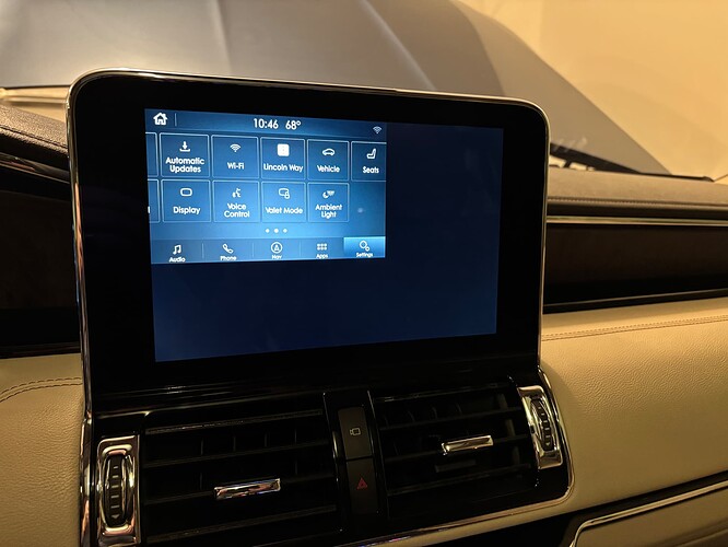

Updated from Sync 3.0.22326 to Sync 3.4.23188 and now have a small screen in top left corner...
I updated from Sync 3.0.22326 to Sync 3.4.23188 in my 2019 Lincoln Naviator (with navigation), and now the home screen is small in the top left corner of the display, and overlays the nav map below that spans the entire screen. I’ve uploadeed the log file, but don’t see an updated log if there was one created after the installation. Any ideas on how to get the correct display? I took pictures of the screen in the Navigator to illustrate the issue, but don’t see a way to upload photos.

Can you post a picture of the screen?.
Is the screen OEM?, what size is the screen?.
Do you have Forscan an a compatible adapter?.
OEM screen, 10”. I was able to post pics of the issue. I’ve got ForScan as well.
Can you please share the asbuilt for the APIM seen through Forscan?.
I’m curisous to see these 2 values:
Boot/Splash image → DE01/7D0-02-01: xxxx-**xx-xxxx
Visual Design (Theme) → DE02/7D0-03-01: xxxx-**xx-xxxx
Will do. I’m not a ForScan Jedi, but should be able to get that in short order. I appreciate your help!

Try changing 7D0-03-01: xxxx-**xx-xxxx from 03 ( 03=Lincoln MY20 (6.5"/8" Screens) (Old Lincoln Next, in 3.4 sets Lincoln MY20 theme with custom Boot Screen) ) to 07 (07=Lincoln 10L MY20 (10" Landscape) (Lincoln 10L MY20 10" Landscape theme with custom Boot Screen)).
Then, reset the APIM from Forscan and see how things go.
Wow! Success! You’re a genius. Thank you for the help!
You are welcome, I’m glad everything is back to normal.
