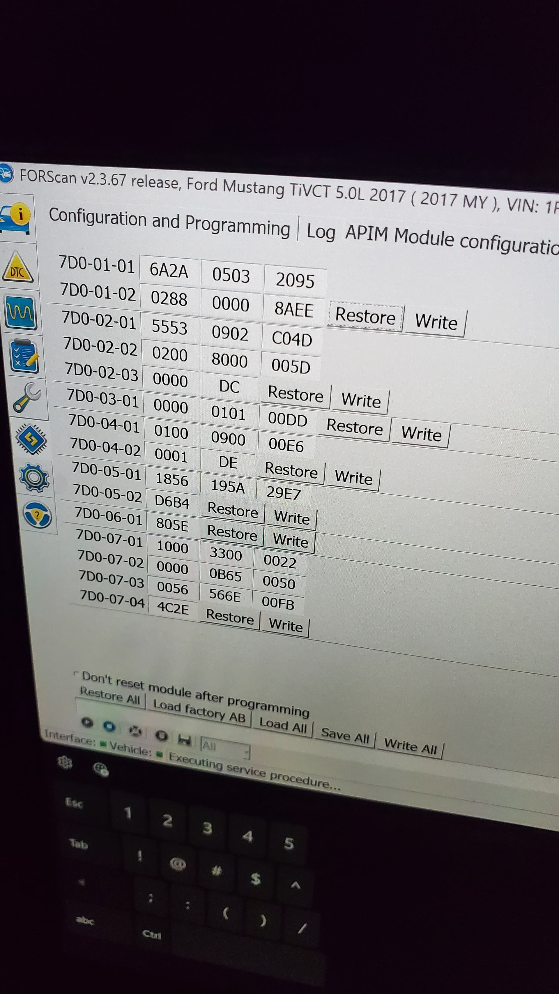

Please post the config file that you have loaded in your APIM.
Somewhere you’ve got a bit set incorrectly.
Sorry im a noob at this where can i get the config file to post?
Here is some of them so far until i figure out how to export the whole thing
i was able to find my VIN number of my old 2016 mustang gt that i had 6 years ago. it was equiped with SYNC 3 from factory premium with satllete radio, didnt have HD radio tho, and didnt have navigatio, it did have drive modes. i found the ford asbuilt values on thier website. and comparing the 7D0 numbers some of the top bit sets are different. the thing is that now i have navigation on this sync 3 and HD radio and the old 2016 gt didnt have navigation or HD radio so im not sure which one to change or imitate.
2016 gt mustang values below from using VIN on fords asbuilt website.
| 7D0-01-01 | 622A | 0502 | 208C |
| | 7D0-01-02 | 0088 | 0000 | 82E4 |
| | 7D0-02-01 | 5553 | 0602 | C04A |
| | 7D0-02-02 | 0200 | 8000 | 005D |
| | 7D0-02-03 | 0000 | DC | |
| | 7D0-03-01 | 0000 | 0101 | 00DD |
| | 7D0-04-01 | 0100 | 0900 | 00E6 |
| | 7D0-04-02 | 0000 | DD | |
| | 7D0-05-01 | 1856 | 195A | 29E7 |
| | 7D0-05-02 | D6B4 | | |
| | 7D0-06-01 | 805E | | |
| | 7D0-07-01 | 1000 | 3300 | 0022 |
| | 7D0-07-02 | 0000 | 0B65 | 0050 |
| | 7D0-07-03 | 0056 | 566F | 00FC |
| | 7D0-07-04 | 4C2E | | |
| | 7D0-08-01 | 0000 | 0000 | 00E0 |
| | 7D0-08-02 | 0000 | 0000 | 00E1 |
First of all, look for DTC’s in the APIM and correct those. You should reload your asbuilt completely and master reset the APIM afterward.
To reload the asbuilt, select the LOAD ALL button on the bottom of the APIM asbuilt page, select your APIM backup file, and load that file into FORScan. Select the Write ALL button and tell FORScan to overwrite or force write the asbuilt. Once the APIM reboots, perform a master reset. This will clear out any corruption if present from the 3.4 upgrade. Test and see if there are issues and look for DTC’s.
