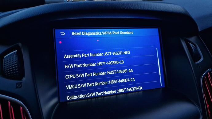

My APIM in my 206 Focus is not the original one for the car. When I bought the car it had Sync 2 and I bought a sync 3 unit and upgraded it about a year ago.
Here is most of the info I can find for my APIM; if you could let me know which numbers are what that would be a great help -
JS7T-14G371-NED, HB5T-14G374-CA, HB5T-14G375-FA, GB5T-14G379-AA, HB5T-14G379-BA, HS7T-14G380-CB, F1DT-14A073-EF, F1DT-14C094-AF, F1DT-14C095-AF ,F1DT-14C403-AC, F1DT-14F119-EC
Please let me know if the version is listed above? I have read through most of this thread but nowhere on here or a google search really identifies fully which one is the APIM version?
I found the above codes through a log profile file of forscan previously and recently saved from my car

I understand my CURRENT existing firmware is JS7T-14G371-NED ? So what is the number next to this in brackets - HS7T-14G380-CB ?
For these MY18.5 files, is there a certain order these need to be loaded into FORScan? I think i read somewhere that they need to be in a certain order.
I have attached a couple pictures of my APIM that I managed to get from the test menu earlier today
I’m sorry for being frsutrating; I just want to only make one attempt at this update and hopefully a successful one
Thank you
That is the model of the APIM, not firmware. The other number is just a Ford hardware number, not important.

(Originally Found On 2017/Early 2018 Units That Ship with 2 USB Ports on Back)
GB5T-14G376-AA
HB5T-14G374-CA
HB5T-14G375-DA or HB5T-14G375-FA (HB5T-14G375-CA NON-NAV)
GB5T-14G379-AA
HB5T-14G379-BA
Files:
GB5T-14G379-AA.VBF (2.6 KB)
HB5T-14G374-CA.VBF (657.4 KB)
HB5T-14G375-FA.VBF (709 Bytes)
HB5T-14G379-BA.VBF (2.3 KB)
what would the recommended flash procedure be as i just used your rescue file to fix my brick
