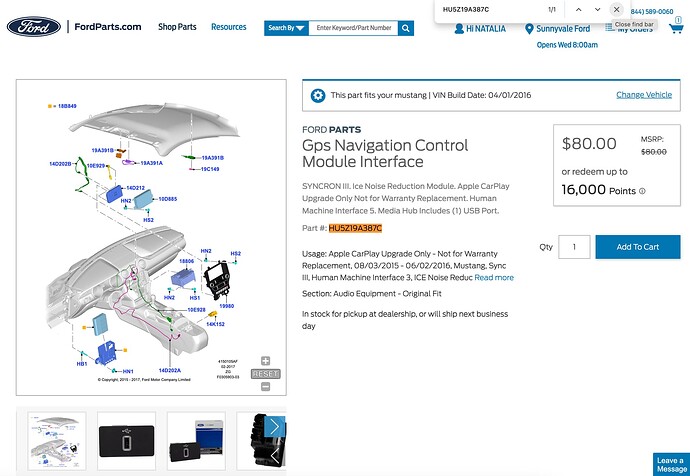

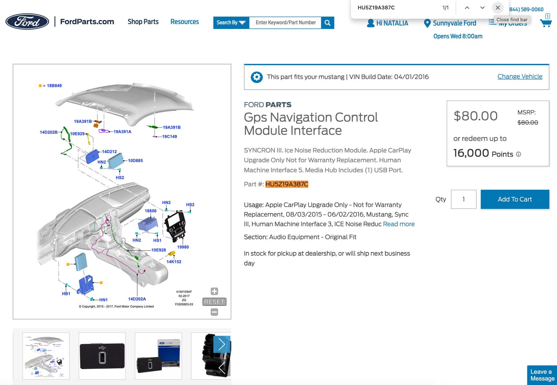

HU5Z-19A387-C (BLUE BACKLIGHTING) Ford (Wide 1 USB-A Port, w/Pass Through)
And I heard the sigh in that yes…
:laughing::woman_facepalming:
HU5Z-19A387-C
Ok, yes, I looked at it before (see below).
@F150Chief : One more detail: I’ve tried an aftermarket radio on my car (didn’t like it / other issues) and wired CarPlay worked with it on my car – without a USB hub swap – that’s why the question – can the problem be in something other than USB hub?
