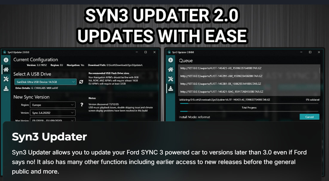

Yep, Syn3updater was created to do what Ford does not want for you: to go from 1.x, 2.x or 3.0 to 3.4, that’s why it works for 3.4 and not 3.0.
This is explained in the app’s page:
If you want to do stuff between 1.x and 3.0, you do that manually (files are available here as well).
