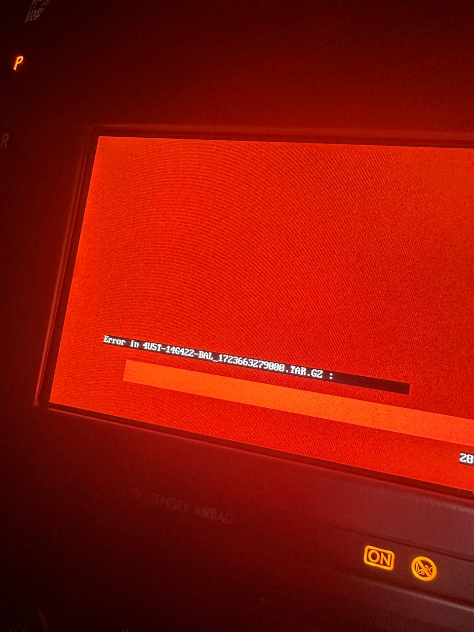

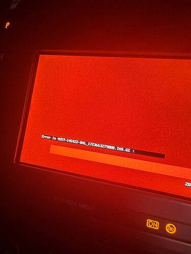

Thanks, I’ll give it a try. I hope I have enough space. It’s almost 27 GB. Hopefully there won’t be any errors. I’ll let you know if it works out. Thank you.
I tried it a while ago, I don’t remember exactly what format I did it in, but I got an error during installation.
I will try to delete everything from my USB-Flash and install it again.

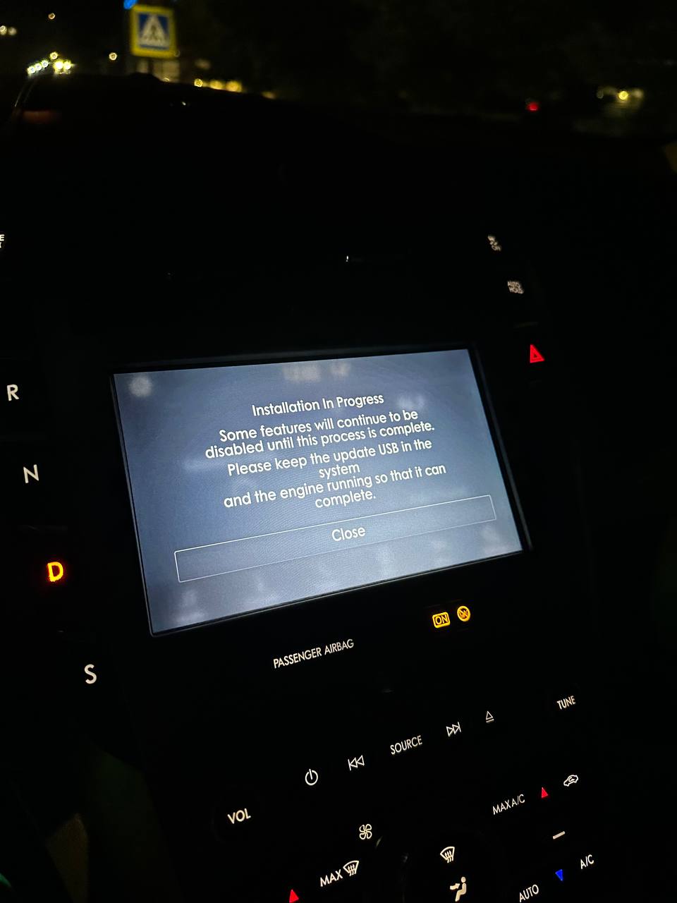

Did you run the engine? looks like it shut down at 1/2 hour…
Installation was successful, but all voice control remains in Dutch, I want to put everything in English. Also after which the installation went through, I was told to remove the USB, but after enabling sync, it tells me every time that I need to insert the USB to continue the installation. I inserted the USB once and it re-installed. I also did a Master Reset after the installation.
I left a picture. Any help would be greatly appreciated. Thank you very much!
