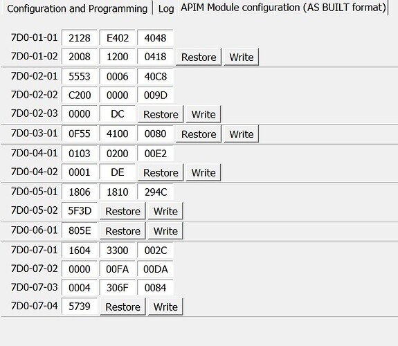

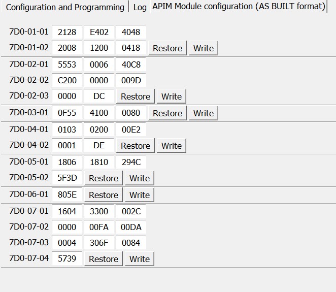

Here is my APIM asbuilt:

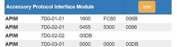

Here is the asbuilt I get from the ford website using my VIN:

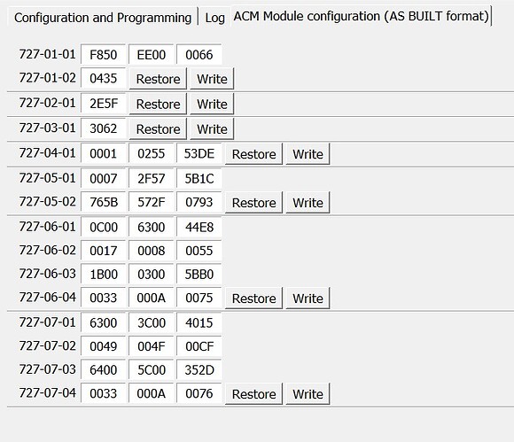

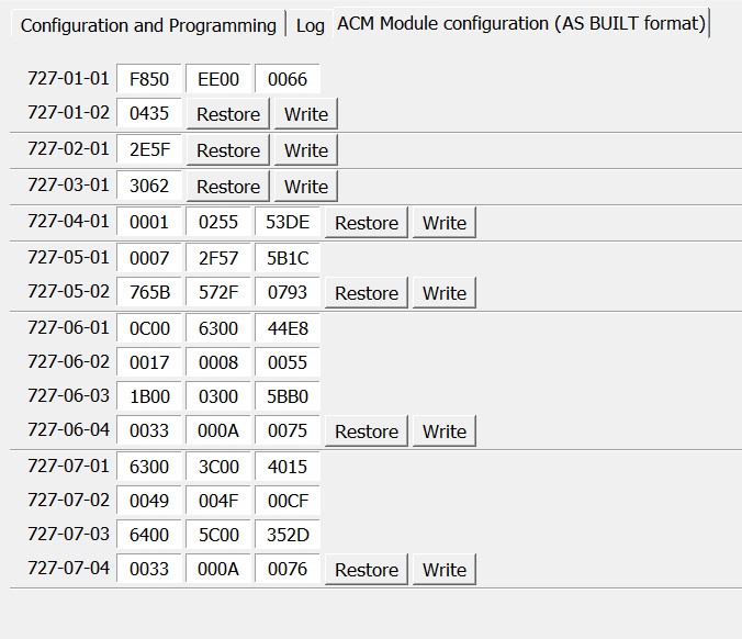

This is my ACM asbuilt. This matches the asbuilt for my VIN as this is the factory ACM:
