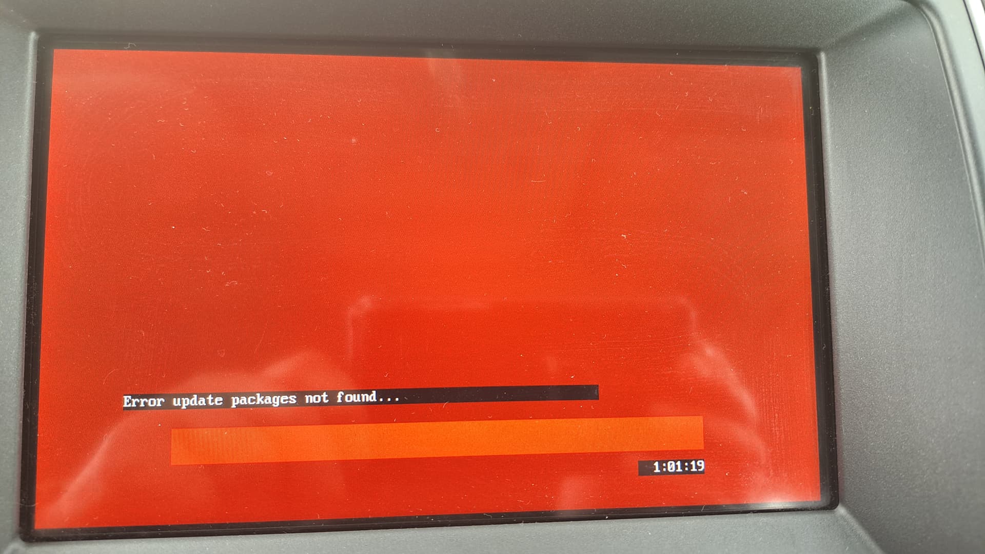

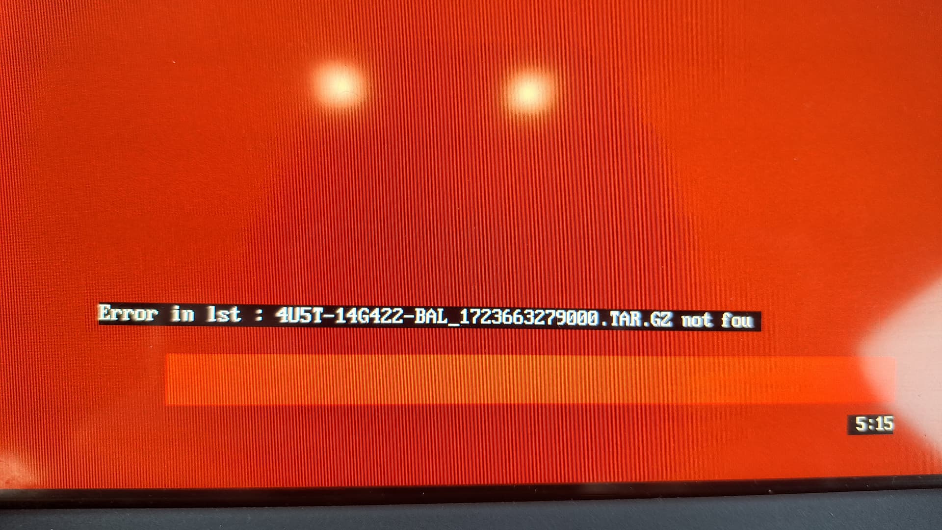

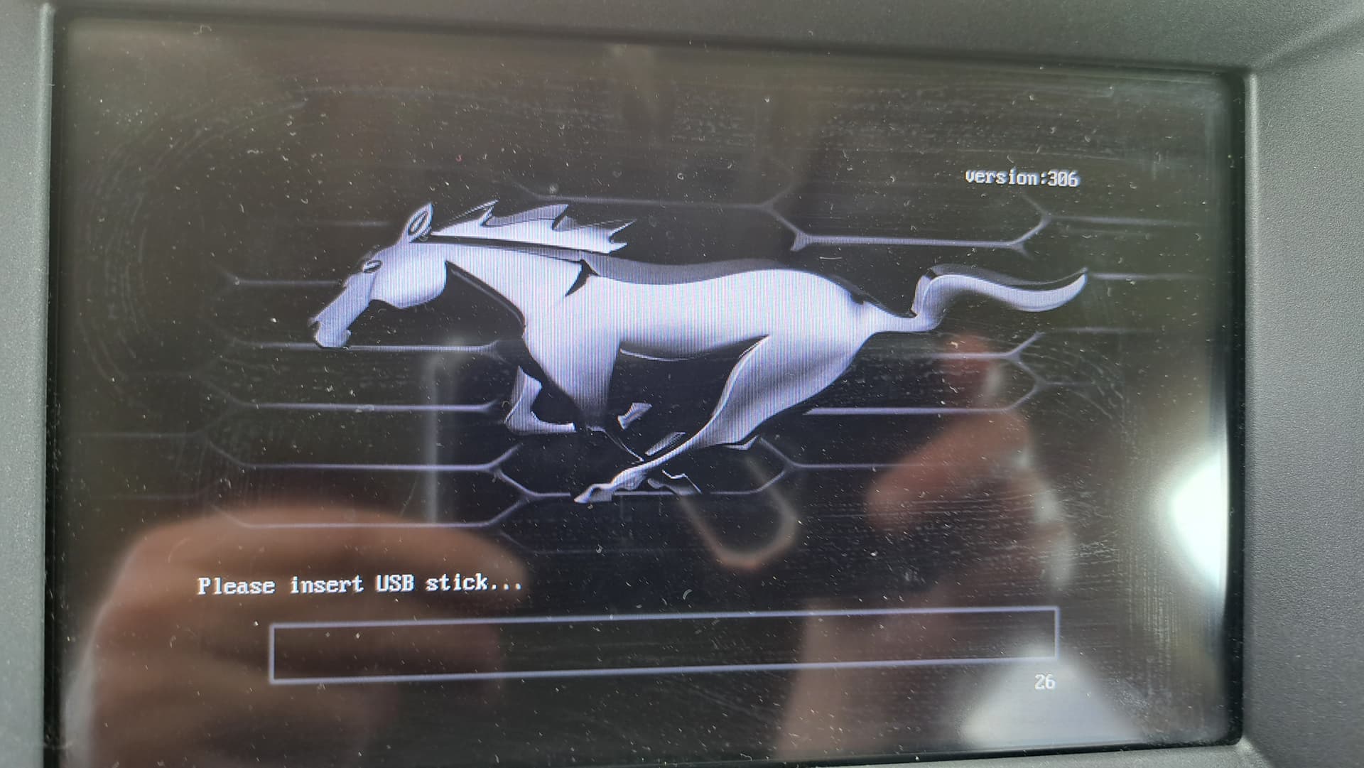

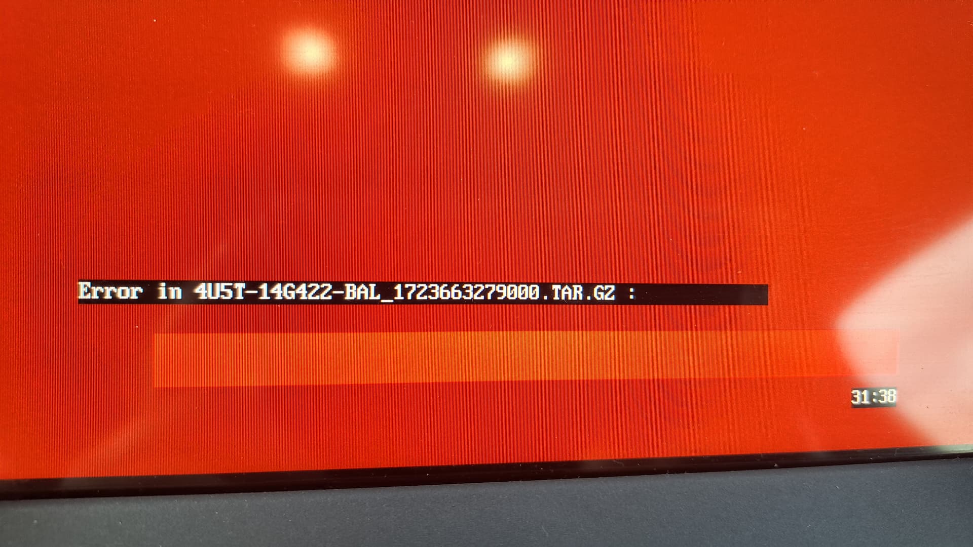

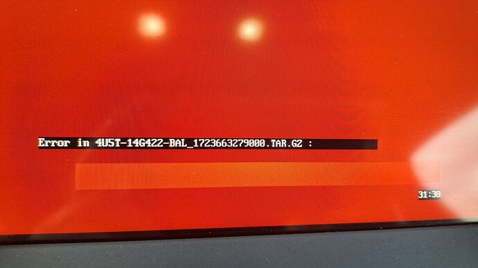

When updating from version 3.3.18201 to version 3.4.23188 EU with cut maps received a red screen with an error
when upgrading from version 3.3.18201 to version 3.4.23188 EU with stripped-down maps got a red screen with an error ERROR in 4U5T-14G422-BAL_1723663279000.TAR. GZ, the update has stopped and is stuck. How to pull off and revert at least to the previous version
при обновлении с версии 3.3.18201 до версии 3.4.23188 EU с урезанными картами получил красный экран с ошибкой ERROR in 4U5T-14G422-BAL_1723663279000.TAR.GZ, обновление остановилось и застряло. Как сдернуть и вернуть хотя бы к предыдущей версии
Install Type: Unknown
Old SYNC Version: 3.3.18201
Operating System: Майкрософт Windows 10 Корпоративная LTSC (2009)
Version: 3.3.18201
Install Mode: Автоопределение (reformat)
My20 Protection Enabled: Отключено / не MY20
Model: Kingston DataTraveler 3.0 USB Device
MAP=1U5T-14G421-BCL_1723600422000.TAR.GZ
MAP=1U5T-14G421-BDL_1723600797000.TAR.GZ

If you are installing what is indicated in the log file it will not work unless you have changed the APIM to an EU unit with 64GB memory. The 2018 Edge would only have the 32GB APIM. What you posted is not a cut down EU map install.
You have probably used all of the memory. The unit might not be recoverable. Whay do you see when you turn on the vehicle, does it show the Mustang/Horse/Ford logos, or is it black?
8.jpg…]()
I will make some correction to the initial data. I’ve provisioned a service pack via Syn3 Updater with the update of both Sink and the map immediately, but, apparently, he was in a hurry, deciding that he could rely on an automated method of updating. The maps in Cinque were NA 1-17. Sink’s version is 3.3.18201. I know that this Sink has 32 GB of memory, so I was preparing a flash drive with an update, leaving only maps of Europe (Belarus, Russia, Ukraine, etc.), and accordingly a package with the Russian language. But when updating, about 25-30 minutes later, an error popped up on the file 4U5T-14G422-BAL_1723663279000.TAR. GZ with a red screen. After I took out the flash drive, the screen is not black, but with an invitation to continue updating. What I did: I deleted the file with the error and inserted the flash drive again. An error came up that this file is missing. When trying to upgrade without maps to version 3.3.19052, the error appears that there are no update files. Can you tell me how to complete the update? Now the system is in a constant request to continue updating.
Подготовил такой вариант обновления, пожалуйста посмотрите всё корректно здесь?
I have prepared this update option, please check if everything is correct here?

this is a English community, speak English or use Google translate
So, it’s in a reformat loop…
  1. Download Sync 3.3.19052, 4U5T-14G381-AN_1552583626000.TAR.GZ
  2. Get a blank USB formatted EXFAT with the following:
    a. In the root of the usb, place the reformat.lst file that is attached below.
    b. Create a SyncMyRide folder.
    c. In the SyncMyRide folder, place file 4U5T-14G381-AN_1552583626000.TAR.GZ.
  3. Insert USB in the vehicle Sync USB port and wait for the installation to finish.
  4. Reboot the Sync unit.
  5. This will recover the unit to Sync 3.3.19052.
The Sync unit will only have the Sync app installed now, no voice files, maps, etc. At this point, you can now update or reformat the unit with the current Sync version with the appropriate files (and maps for NAV units). Use the Syn3 Updater and enter the current version as Sync 3.3.19052 along with your region information, etc.
