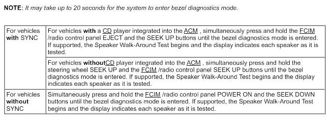

This is a bit of a reach, but try disconnecting the battery on the vehicle for about 30 minutes, then reconnect and start the vehicle. See if this boots the APIM beyond where it is.
I want to try everything and will do that first thing in the morning.
By disconnecting the battery…you mean get both poles off and let it stay for 30 minutes.
I hope this will bring back some life in the APIM
On top of what’s been said and suggested, does the unit exhibit any sign of life? (Radio, powered USB ports, backup camera, phone pairing)
No nothing as far I’m seeing.
USB port doesn’t light up my thumb drive,.
No radio, phone pairing or rear camera
Has the unit or screen ever been serviced?
Yes. Just drag it here.
No, I bought it as an upgrade for my Sync2 system as a replacement
Sync__WF05XXGCC5GA12762.xml (11.3 KB)
I think you mean this log?
In the meantime I tried the combination eject button and seek > with no result.
Also I disconnected the battery for 30 minutes, which also didn’t get the life back in the APIM :sad_but_relieved_face:
