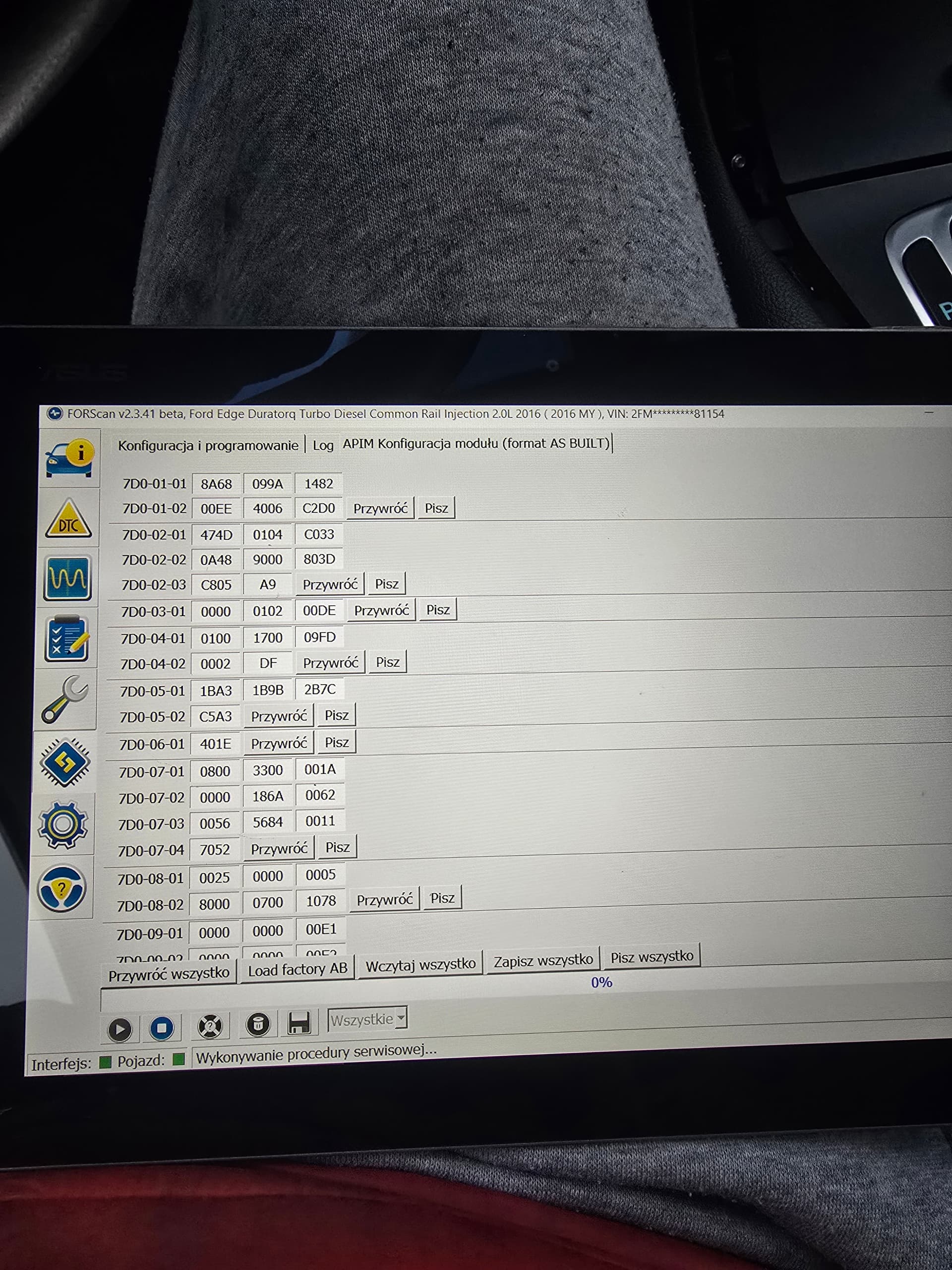

My new Sync 3 that I installed came from a 2019 Ford Edge facelift, European version. I haven’t changed anything in the configuration yet, it’s still completely original. This is my AsBuilt.”

Since this is essentially a 2016 NA vehicle in EU, you could just disable the TCU in the APIM asbuilt. Look at your OEM asbuilt to determine if the vehicle is equipped with a TCU.
Communication issue with accessory components like wireless charger module. Likely an asbuilt setting.
Post your original Sync 2 asbuilt.
And update your FORScan version… FORScan 2.3.68 Released 2025-11-10 - Ford / Information - CyanLabs Official Community
You should look for a 2017 basic Edge APIM asbuilt equipped with Sync 3.
I don’t have a TCM module in my car, so my question is how to disable it. I installed only a cheap GPS antenna, which is why the antenna error appears, but navigation still works. I also don’t have a wireless charger, so I probably need to change that in the AsBuilt.

How do I code this out? Can you tell me? I’m honestly giving up at this point
