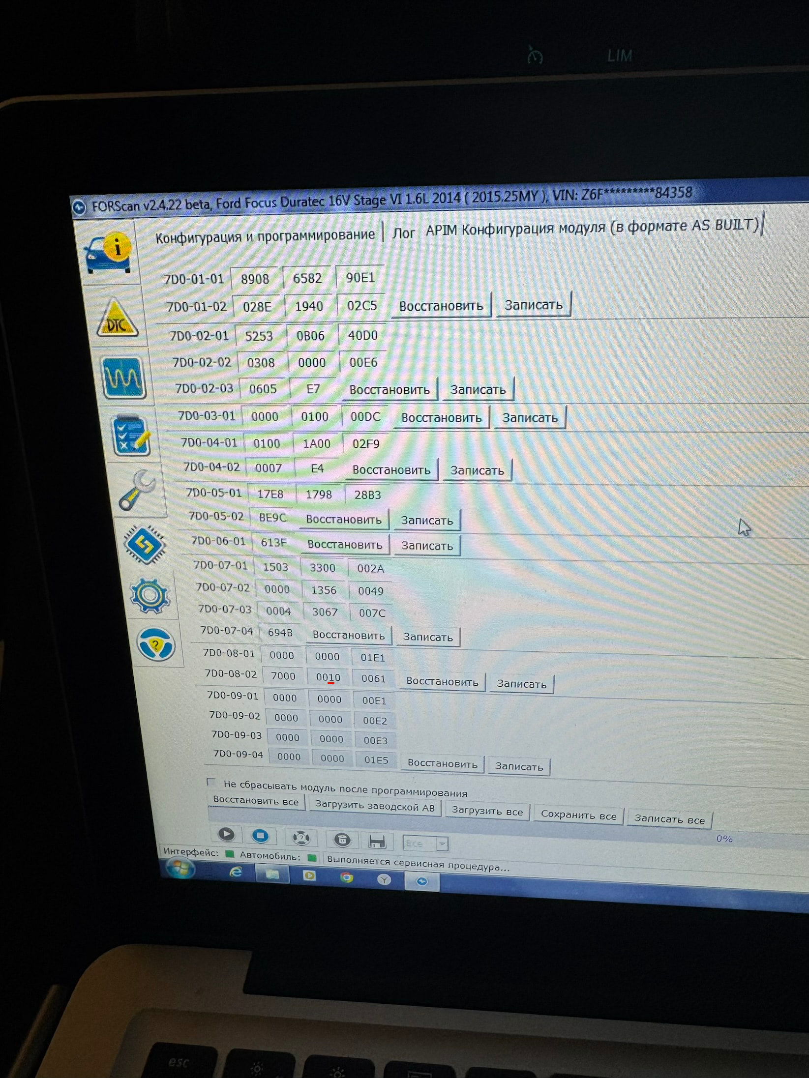

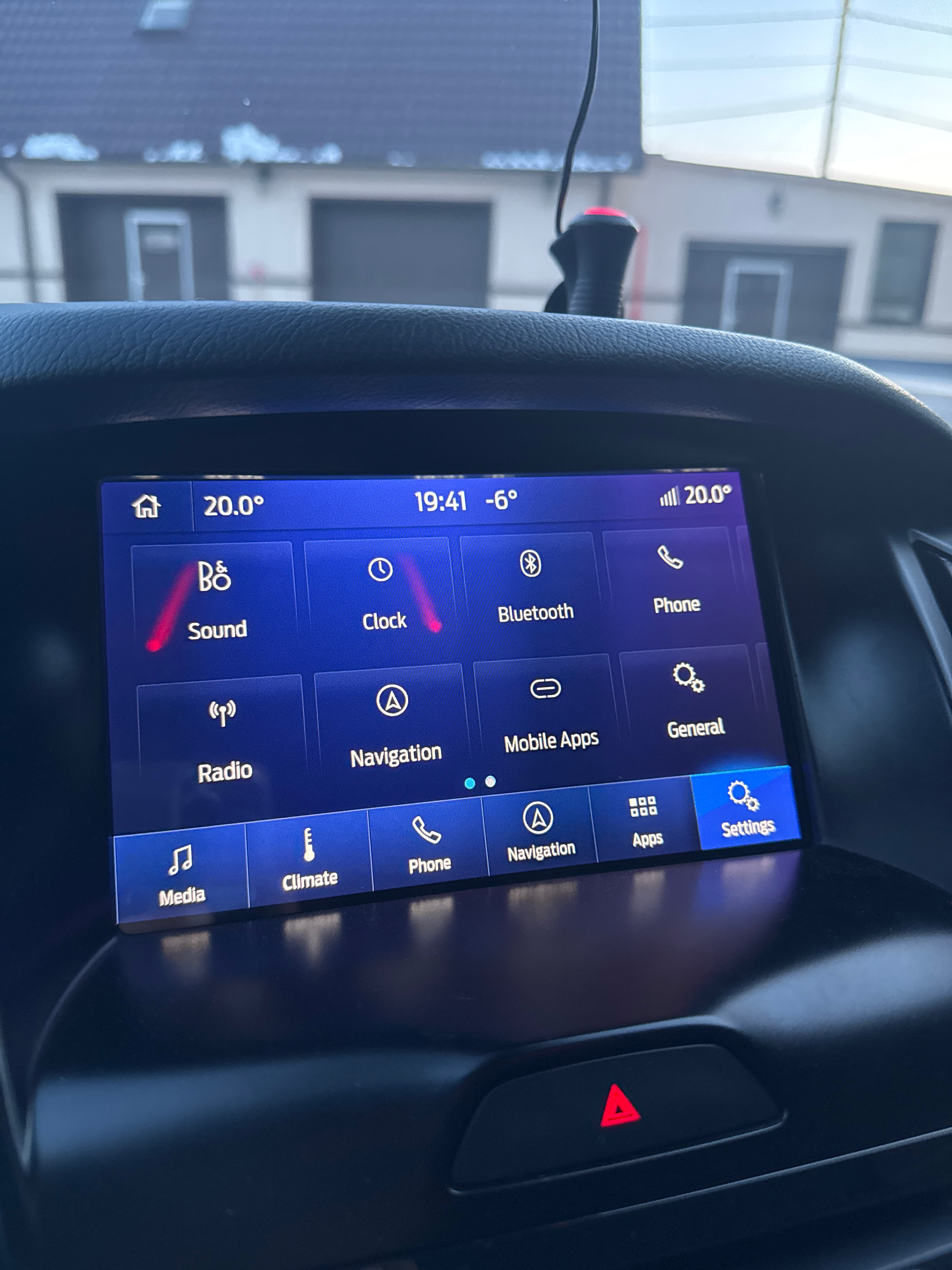

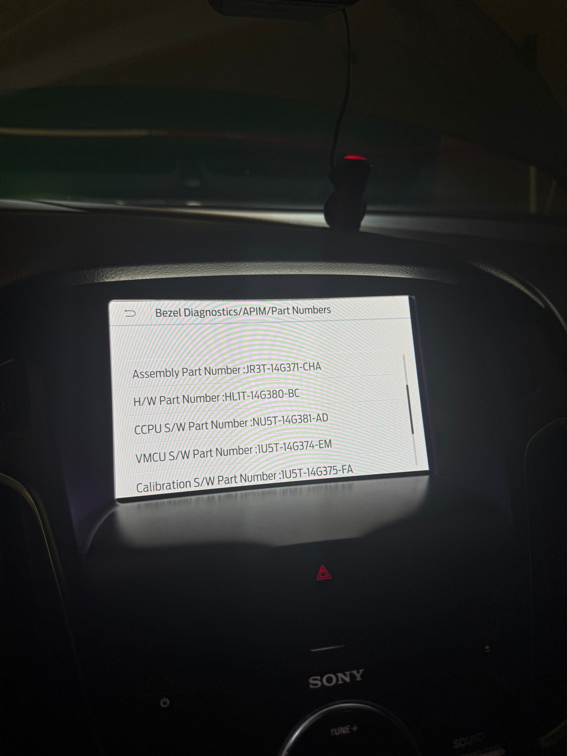

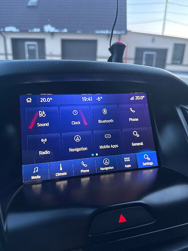

For those who cares, i uploaded calibrations for MY20 with forscan and everything is working great and properly. Also i changed one byte. (marked red)
Those are MY18.5+ calibration files you show in the above pic to be clear, not specifically MY20 files.
