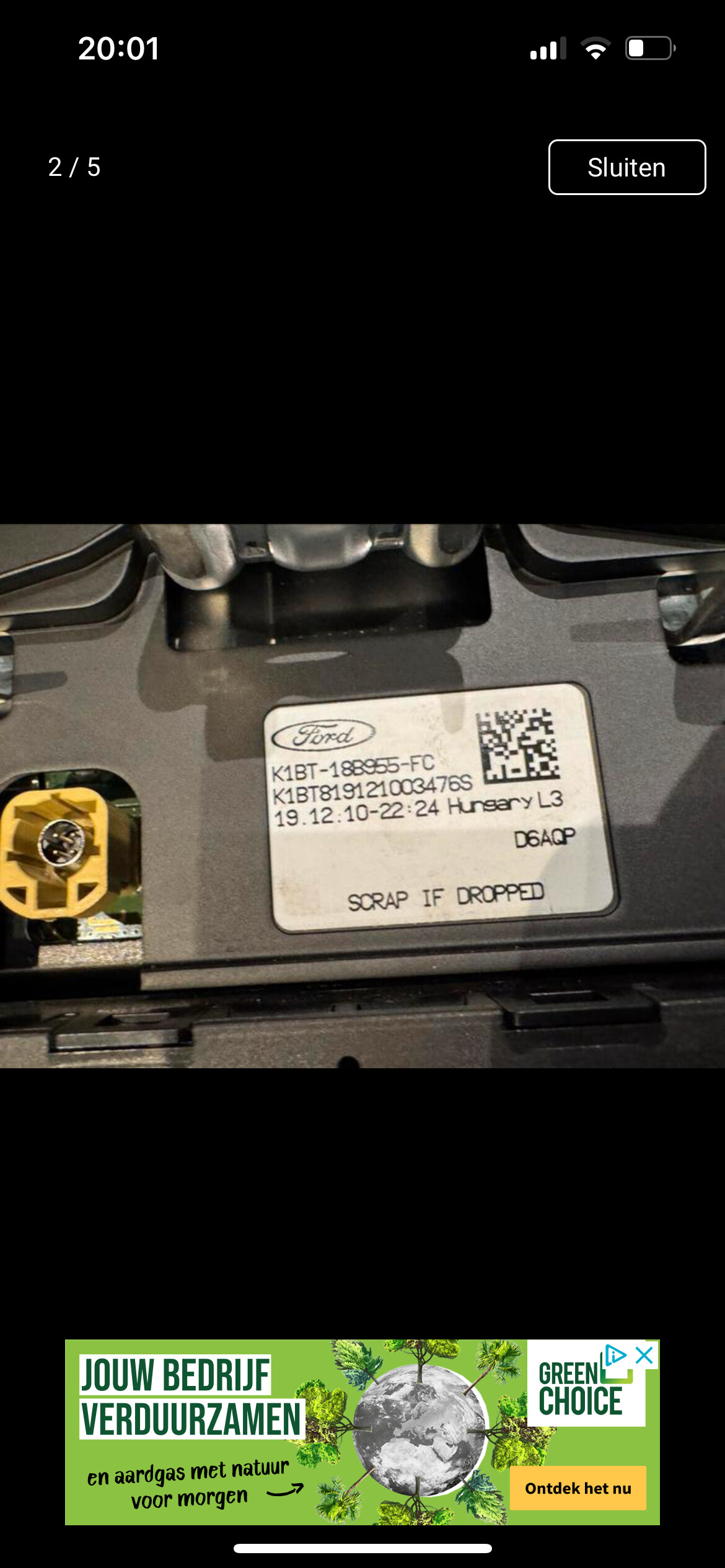

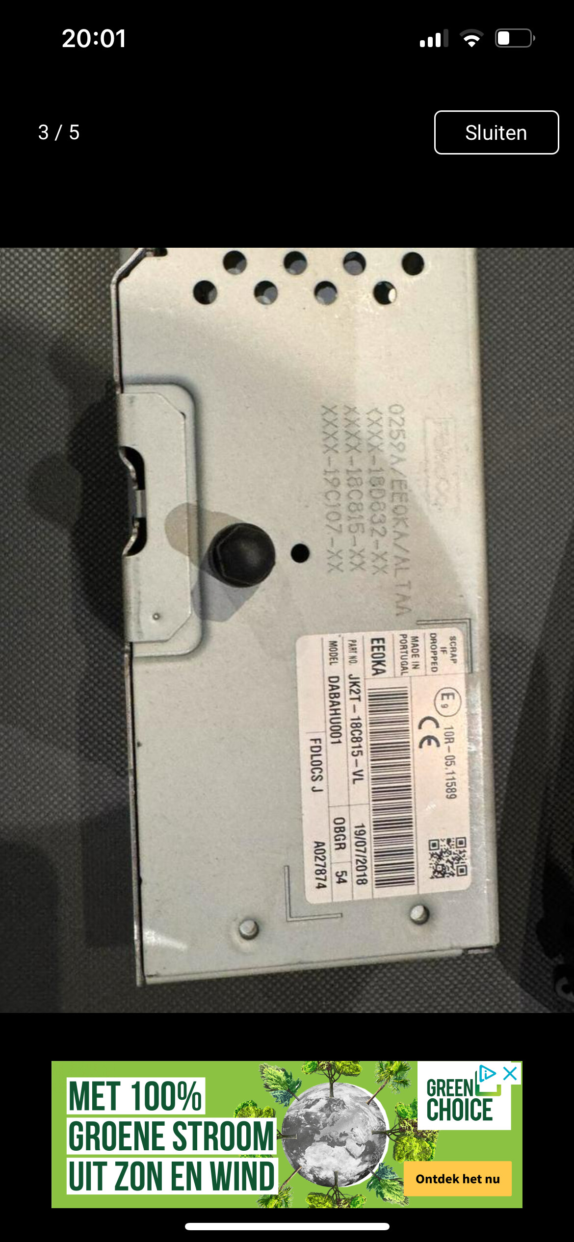

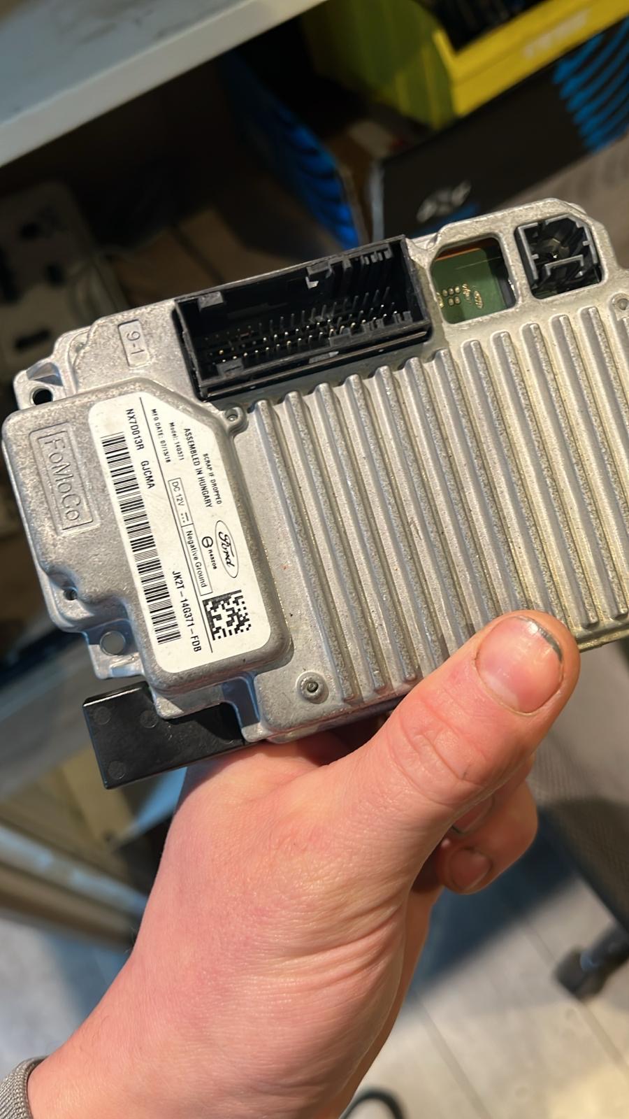

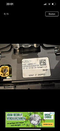

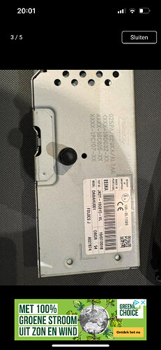

I have a complete system, screen acm apim wiring loom. Al from the same car they told me
Apple carplay works bluetooth works navi works pdc is displayed
