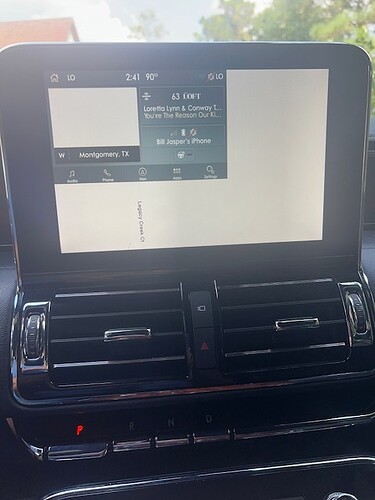

Screen not full size
after installing the update in my vehicle the screen is a quarter the size of original and is only in the upper left corner

Is this a retrofit screen or OEM?
the screen is OEM
Can you share a picture?, something does not add up.
This is a 10 inch display correct? your theme is likely wrong due to changes in sync 3.4 theme references, Lincoln Navigator Sync 3.4 upgrade, incorrect screen size display
Yes it is a 10” display. where do I or can I correct the theme?
It’s literally all in the topic i linked.
Ok, I ordered the cable. I was sure hoping this was going to be an easy upgrade.
This is a documented issue for the Lincoln Navigator with 10" screen when updating to Sync 3.3+. Ford has actually released 2 versions of the Sync 3.0 software just to address this issue. They won’t do this for Sync 3.4 because that version of the Navigator would never be eligible for a Sync 3.4 installation.
