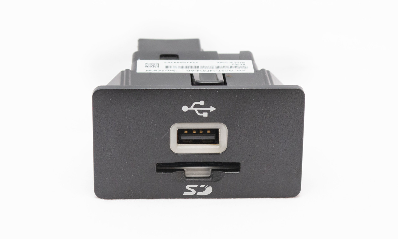

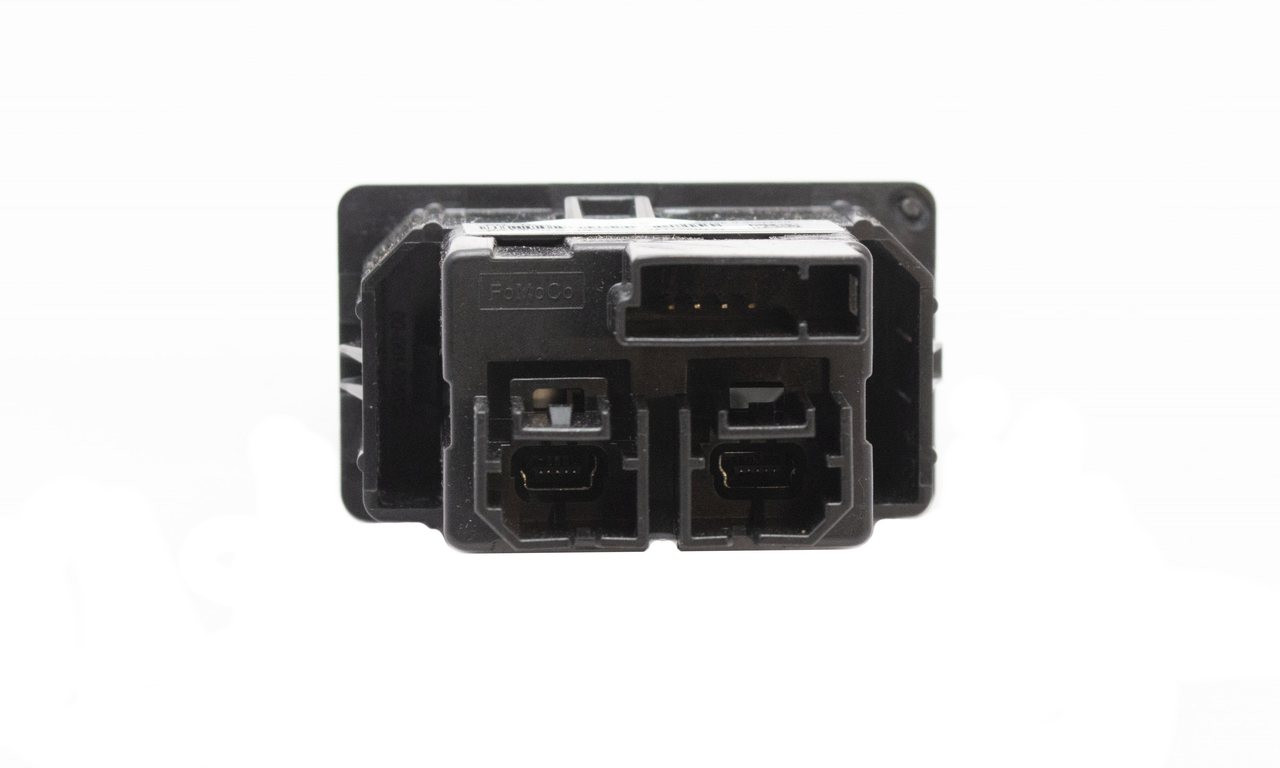

Now one thing is still bothering me: I have the SYNC 2 with front USB below A/C controls, and one USB + SD card hub inside the arm rest. I’ve read somewhere that, in order to retain the front USB, I have to buy an additional USB cable and connect it to the throughtput on the new USB hub. But I’m wondering, is maybe that cable already there in my car? I guess it’s also connected like this on the SYNC 2?
EDIT: I think I won’t need the harness for the USB hub! My USB hub is the one with one USB-A and one SD card slot, no AUX or video inputs! As far as I can see on the pictures, that one has the same connectors as the SYNC 3 hub. So I guess I can just swap it and reuse the existing harness.
