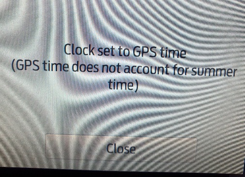

update from EU 3.0 to EU 3.4 20136. Everything works perfectly( i dont use usb for music) but i have an issue with the time on the radio. Time is 1 hour back. Is there a solution?

The same thing happened to me, and I can’t solve it. you could
Fix it. Disable auto sync and now it’s ok
