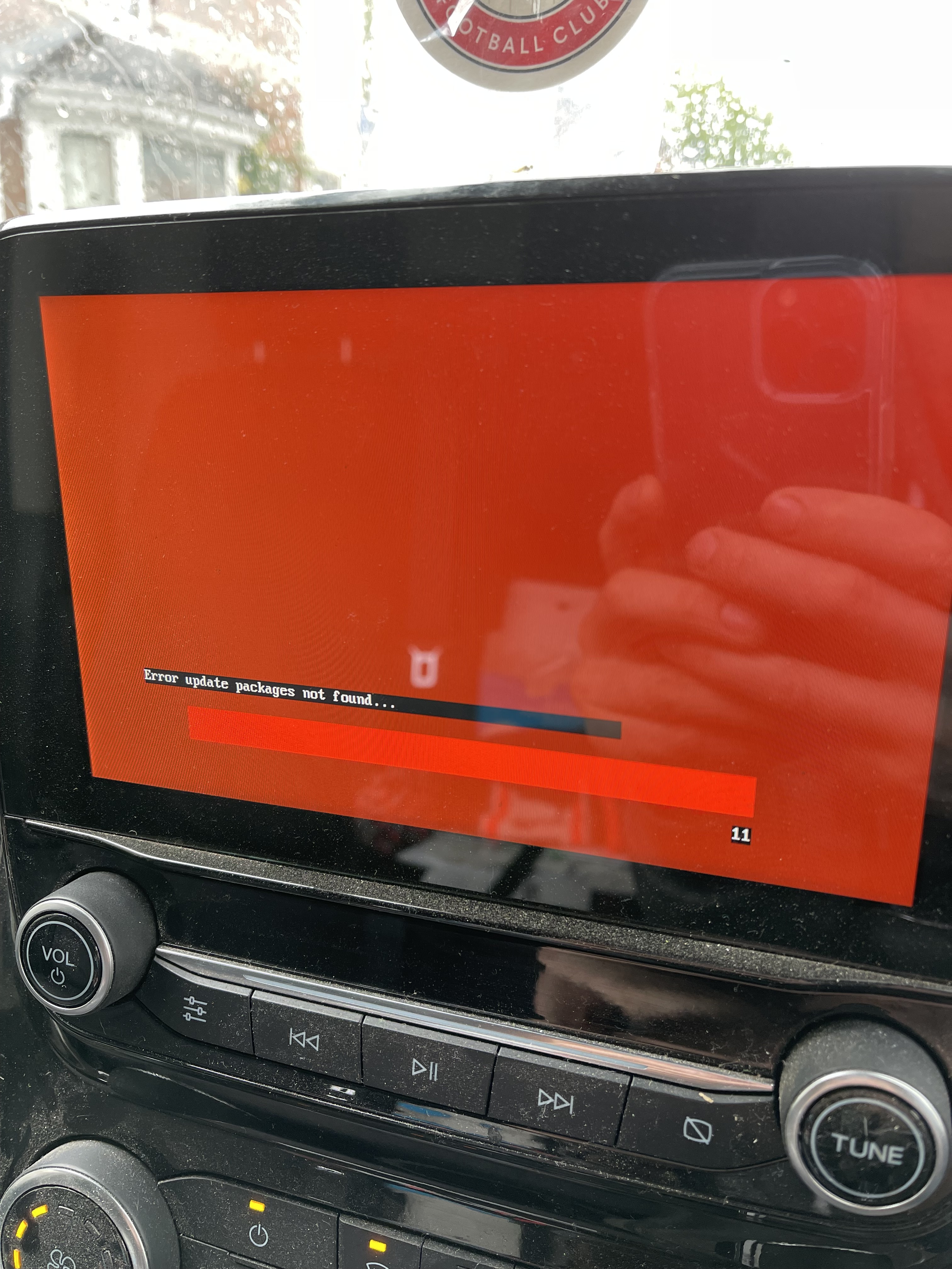

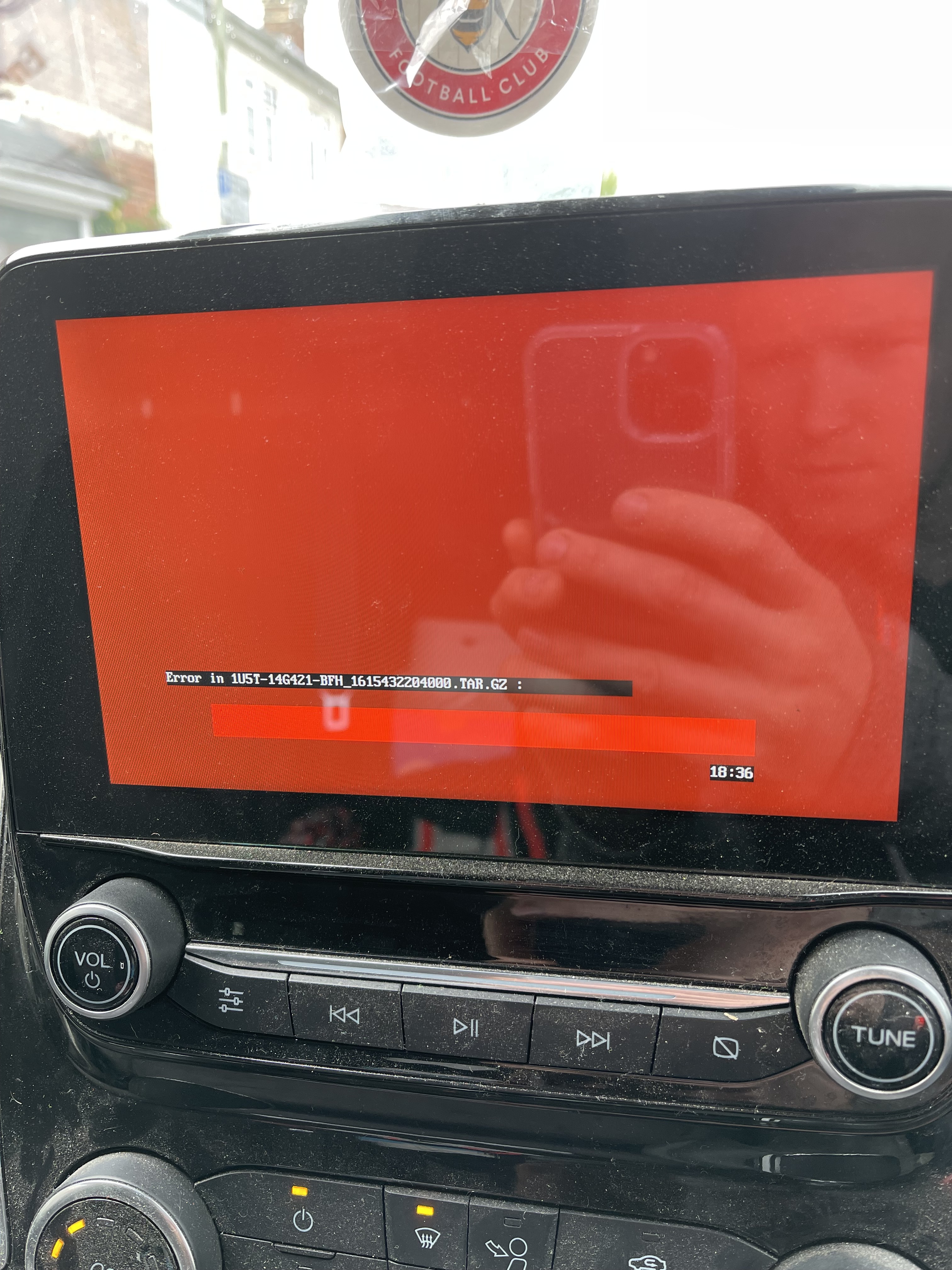

Hi Just tried to update my 2018 ford transit custom sync 3 to sync 3.4
i tried as reformat install first but i had the same screen come up at around the same 18 mins i re downloaded the sync files so i have no log for that one
ive got to 18 mins in of the update and i get this screen
my log also reads as follows

so at the moment ive got no infotainment system some help and advice would be much appreciated
as far as i know i have a nav verison in the van but i now have no way of telling if i do or do not now.
but help would be much appreciated
Further to my last comment i have tried updating with no nav and i get this screen after 8 sec
and my log for this one is as follows
CYANLABS - SYN3 UPDATER - V2.5.7.0
Branch: Release
Operating System: Microsoft Windows 10 Home (2009)
Version: 3.4.21098
Mode: autoinstall
Model: JMicron Generic SCSI Disk Device 1.8TB
; CyanLabs Syn3Updater 2.x - Autoinstall Mode - Sync 3.4.21098 EU
Item1 = ENH_DAB - 1U5T-14G658-AF_1598633324000.TAR.GZ
Open1 = SyncMyRide\1U5T-14G658-AF_1598633324000.TAR.GZ
Item2 = VOICE - 5U5T-14G391-AN_1615393794000.TAR.GZ
Open2 = SyncMyRide\5U5T-14G391-AN_1615393794000.TAR.GZ
Item3 = APPS - 5U5T-14G381-ES_1619042260000.TAR.GZ
Open3 = SyncMyRide\5U5T-14G381-ES_1619042260000.TAR.GZ
Item1 = GRACENOTES - 4U5T-14G423-AC_1615425645000.TAR.GZ
Open1 = SyncMyRide\4U5T-14G423-AC_1615425645000.TAR.GZ
Options = Delay,Include,Transaction
FILES (4)
1U5T-14G658-AF_1598633324000.TAR.GZ (58.8MB)
5U5T-14G391-AN_1615393794000.TAR.GZ (1.5GB)
5U5T-14G381-ES_1619042260000.TAR.GZ (847.2MB)
[16/05/2021 11:54:02] Selected Region: EU - Release: Sync 3.4.21098 - Map Version: No Maps

Most of the messages in this thread are not related to the 21098 build, confidence of keeping the thread clean is quite lost at the moment…
Do not use an external disk @bd271082 , use a USB drive, and a quality one preferably.
Also, do not have anything else connected to other USB ports.
thanks for that i re downloaded and made sure it didnt have nav on and all installed successfully
Thanks. Wouldn’t be Gracenotes included like last update due to storage/ memory constraints in Non navigation unit. Am I correct?
Yes, gracenotes are not included
