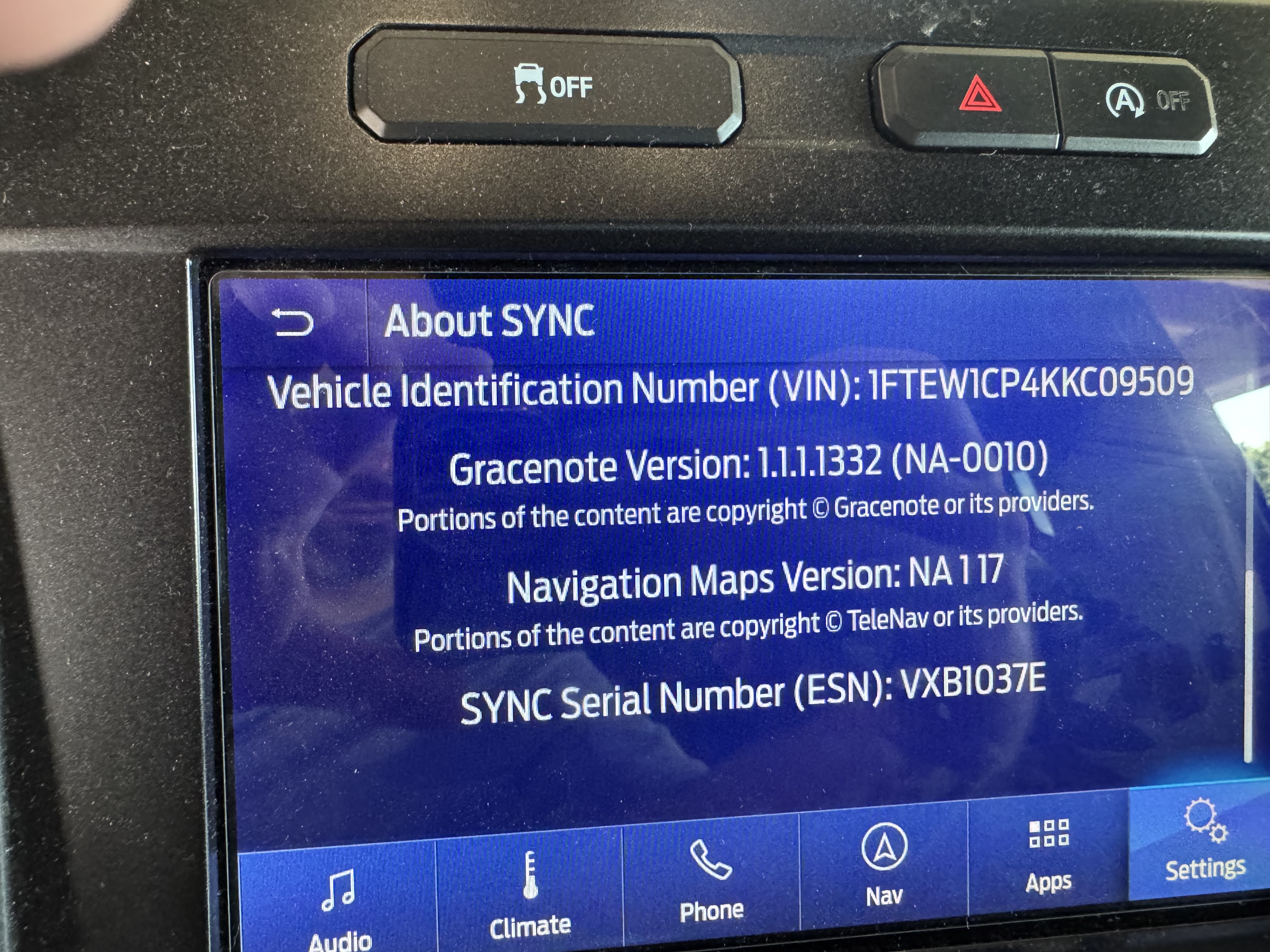

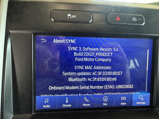

Are you sure that’s your current version?.
Based on what you are describing, you should review this guide → APIM Sync Settings Not Saving, VER_ERR08 Errors, Cannot Perform Master Reset or Upgrades/Updates (Solved)
My previous update was not using cyan labs if im not mistaken. I think it was another method that was posted over on f150 forums. But its been so long that I dont really remember
Im sure of the versions. Ill take a look at your link
You are giving contradictory information then:
This is why I asked you to double check the version, since your current version is not listed in Syn3updater.
Go through the guide nonetheless, since the symptoms are similar but the version is way off… Share the xml file if the unit produces one…
