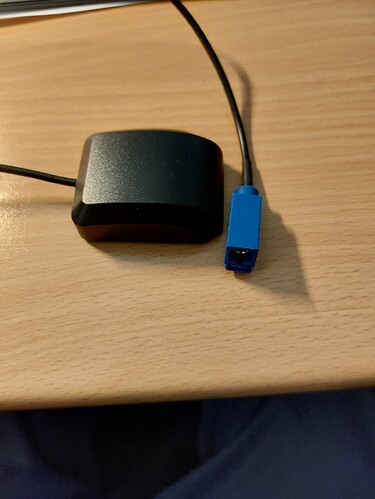

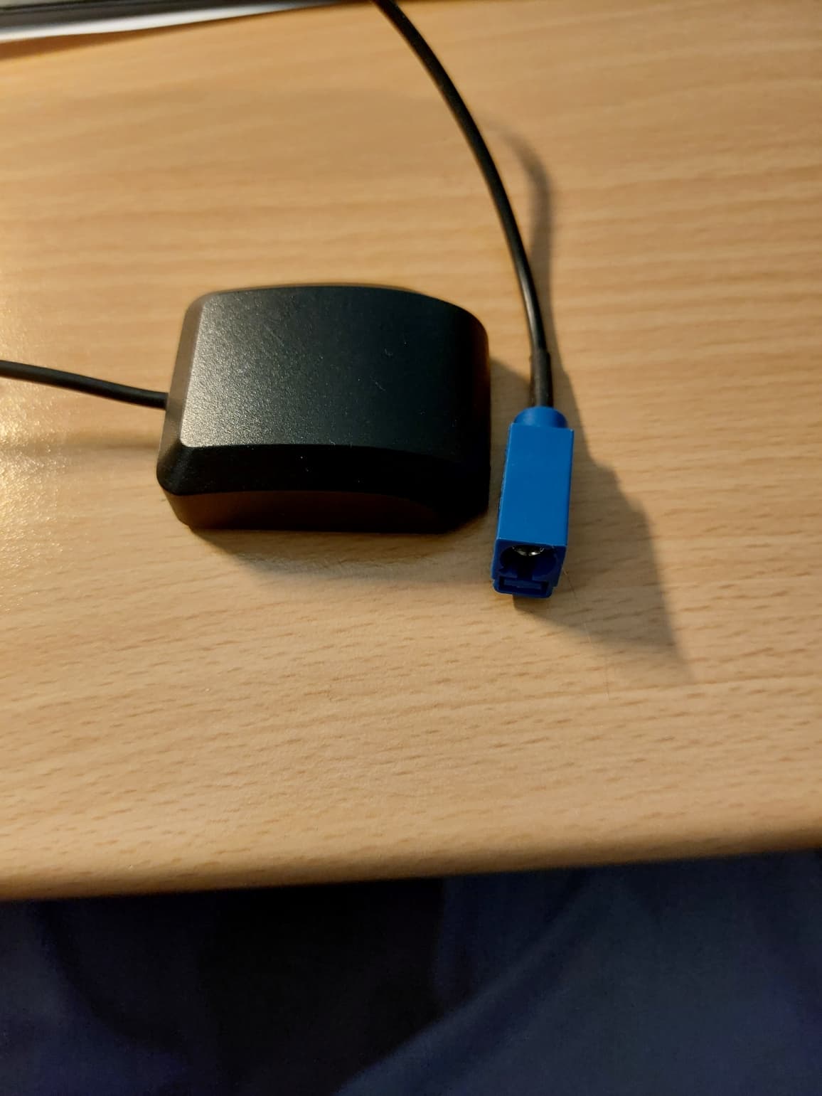

This is an antenna that came with the Sync3. I installed it under the grille, just above the three center vents. I simply unplugged APIM from the Sync2 to replace it and reused the connectors from the Sync3. I don’t remember unplugging the original GPS antenna.

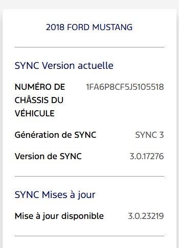

Is this an EU version or US version? And you need to male sure n it came with SYNC3 nav
I found it on a US site, https://autohelperbot.com
I found a 2018 with sync3: 1FA6P8CF5J5105518
it’s still a US
We need the EU versions since you are in the EU to get EU parts.

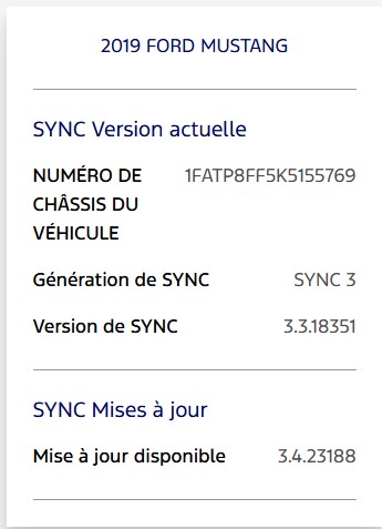

I found this one: 1FATP8FF5K5155769
It’s a 2019 French car with sync3.

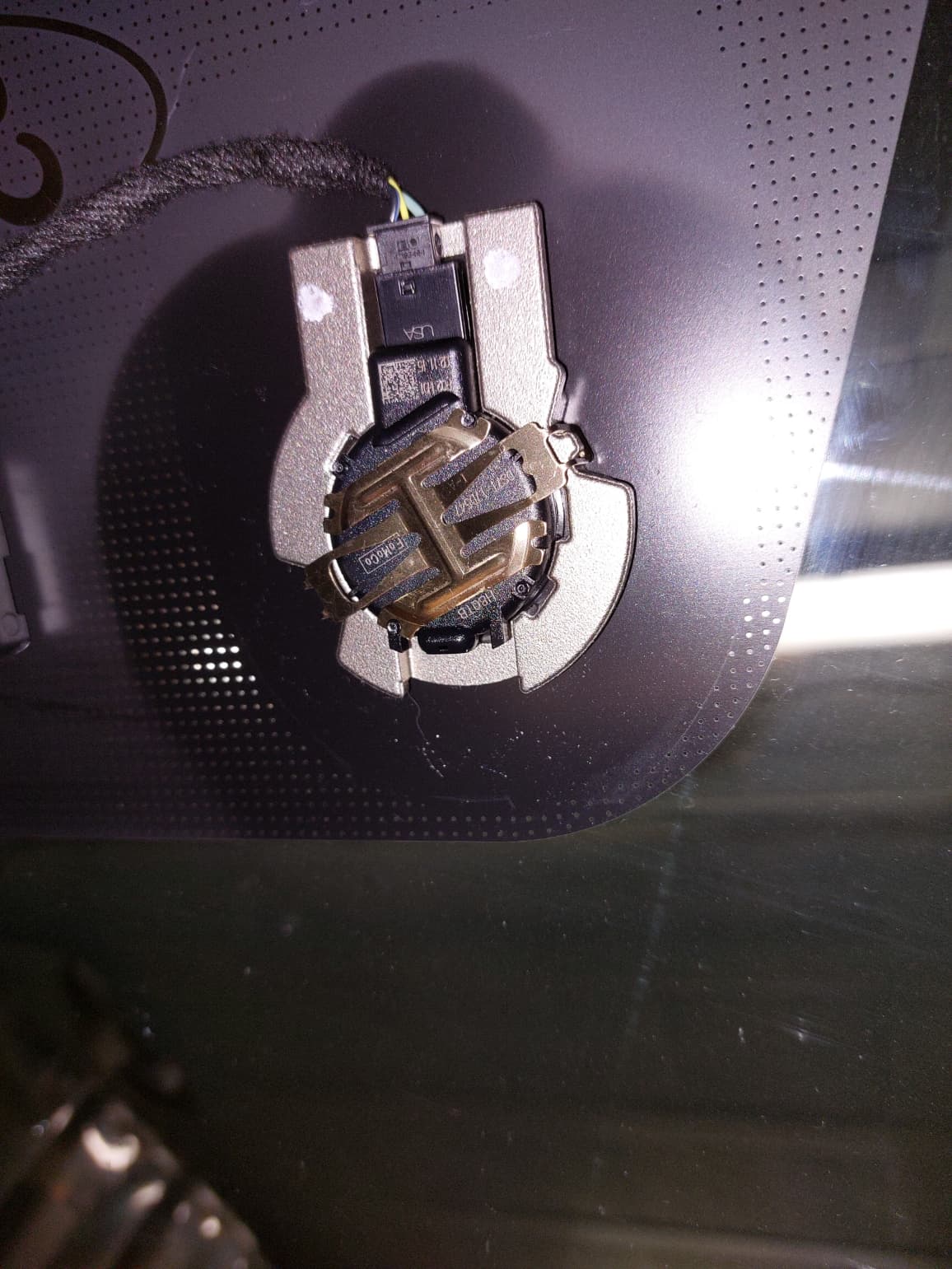

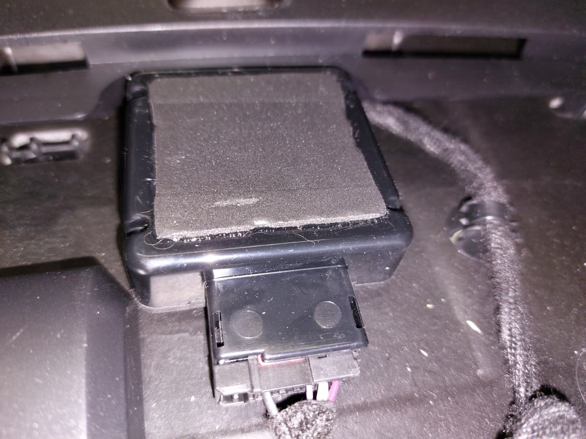

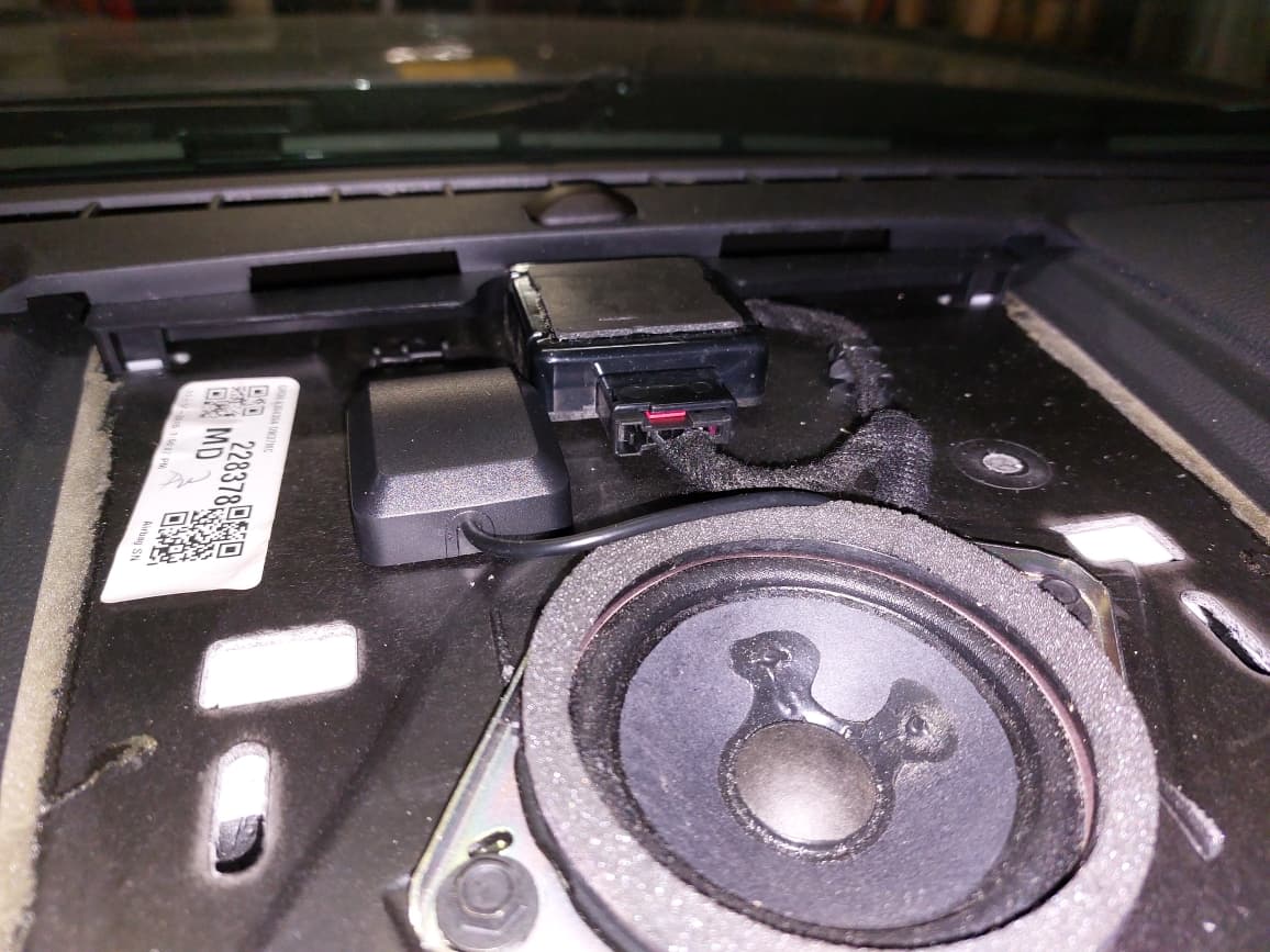

What antennas does your car have. Ideally some photos of those antennas would be grand.
I photographed everything I found :wink:
