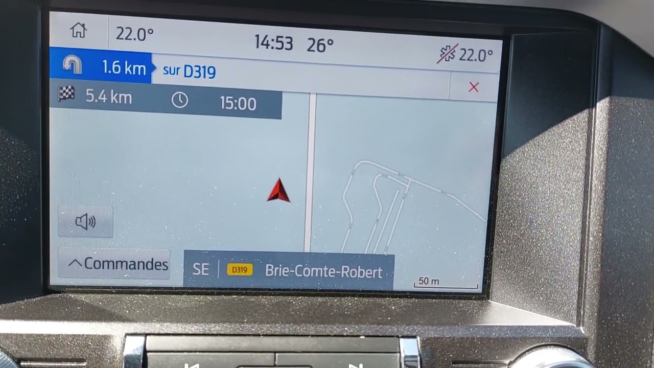

I made a video to better explain the problem
I’ll give you an overview, problem solved :slight_smile:
My car was configured with an automatic transmission instead of a manual transmission, and the antenna location was indicated on the roof, even though it’s actually behind the windshield under the speaker grille.
So I changed it: 7D0-01-02 xx9x-xxxx-xxxx for the gearbox, and: 7D0-03-01 x3xx-xxxx-xxxx
And now my GPS works correctly.
Thanks everyone for your help.
