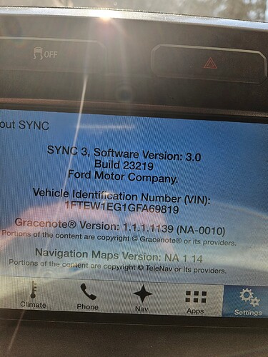

Hey. Everyone. We got the hose replaced and all fixed. My boss handed me a usb saying to update it on the way home which i did. Didnt seem to dobanything till i did a master reset again yesterday. Now it says version 3. Think he did the regular ford update and didnt tell me. Should i install the new usb hub and do a regular update thru the updater? My radio still lags alot and my phone seems to connect but disconnects easily.
Thank you for all help you have been giving me.
Perform a master reset to see if things improve.
Also, does android auto / car play work ?
Hey all, good afternoon. Plugged in the new hub a couple days ago and it hasnt poped up with anything saying unknown hub like before. Phone doesn’t stay connected to the radio long enough to try to see if it works. I plugged my phone into the usb today and it asked me 3 different times to download media but didnt seem to stay connected. Radio is still very laggy. Starting to wonder if its more than just needing updated.
