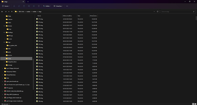

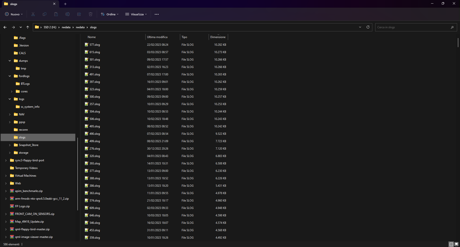

I figured out the reasons why rwdata partition gets full
  1. Missing / Broken slog compression and/or rotation
  2. A bug in Apple Car Play service
The issue number one is mainly due to the fact that the previous #.slog file is not compressed during the ‘next’ apim boot sequence, this thing alone shouldn’t be a problem UNLESS the files itself get really big, and that’s where issue number two has a role. There is a bug in the Apple CarPlay service and as soon as you plug the phone, the slog file start spamming an error and in around 50minutes the log file reach its maximum size, which is a bit more than 10MB. The file is not compressed at the next boot sequence and as soon as you plug your iPhone again, boom, another 10MB file, 10+10+10+10… space fill up pretty quickly.

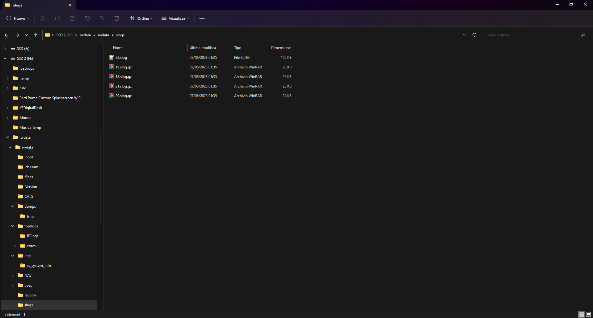

With the new build 3.4.23088 the #.slog file is compressed during the boot procedure, so, even if the Apple Car Play issue hasn’t been fixed (i can’t check, because i like girls, so, I have an Android phone ) the 10MB file, once compressed will result in 500kb zipped log file circa.
What is confusing is the fact that I REMEMBER (but i might be wrong) that in old builds (but i cannot check right now) the previous #.slogs file was DELETED during the boot sequence… so, the slogs folder contained ONLY one file which was named #.slogs where # was the boot counter number. As i said i’m not 100% sure about that, but since the rotation is MISSING (they added / fixed the compression), even with the new build, SOONER OR LATER there will be TONS of files (one for each boot (reformat RESET the counter)) with 500kb or less size, that will fill up the rwdata partition space.
regarding the ACP bug, i cannot 100% confirm that it’s the due ACP itself, BUT from the logs i analyzed, the logs spam started AS SOON AS the user plugged the iphone and ACP daemon started. In all analyzed files.
bugged version
