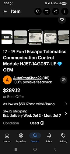

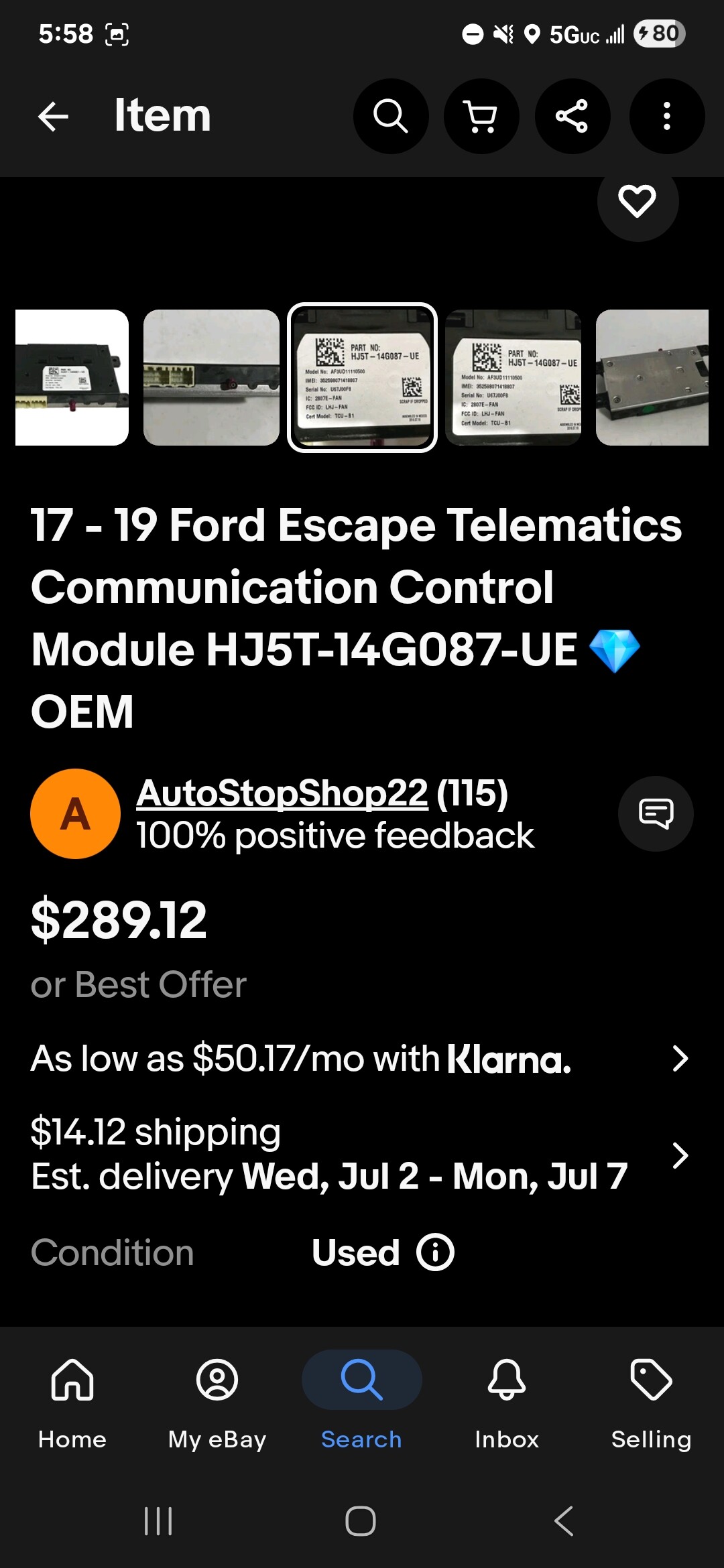

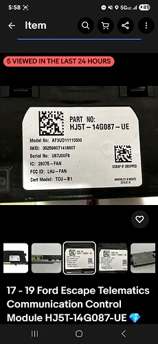

@F150Chief The closest I could find to the correct part number is this.. Is there anyway to use another part number or this one by chance (photos attached reply)? Ive looked everywhere online for the UF-UM and cant find one anywhere. I called the local dealership and they told me whatever part they could get me would cost $800. If possible do you know where I could get one by chance or what vehicles to search at salvage yards?
That will work once you upgrade the firmware, but that’s expensive for a TCU.
@F150Chief would a jl3t-14g087-c* TCU work for him? They are more readily avaliable and cheaper.
@jmbach @F150Chief
It would be nice if it would. Otherwise I’ll most likely buy the one I previously posted. It is quite expensive, but at least it’s been tested and is said to be in excellent condition. I might buy a warranty for it too if so.
It will work but it might take a try or two…
@F150Chief I went ahead and bought the expensive TCU off Ebay. I talked to the seller and received a slightly lower price, but also bought an Allstate warranty with it. So overall it cost $311, with a one year warranty. Pricey, but the ford dealership quoted me $800 for just the part. The other two dealerships I called said they couldnt get it the part, or didn’t want to take the time to look it up.

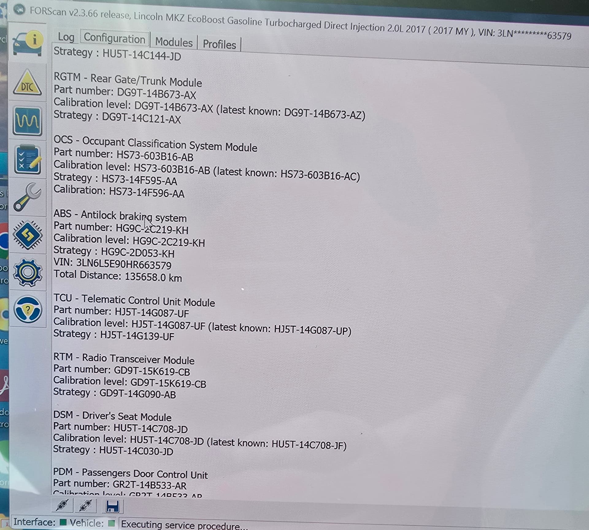

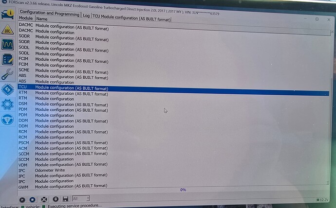

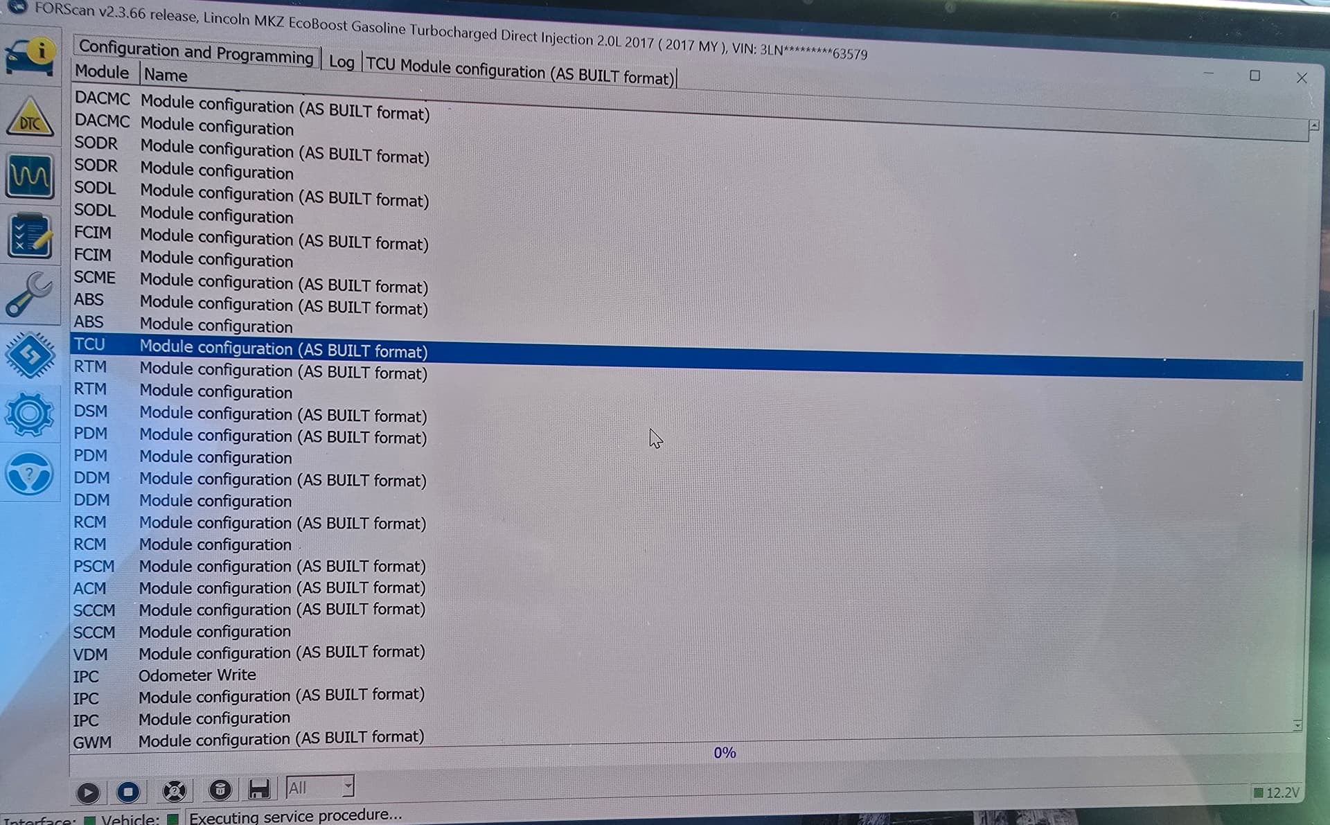

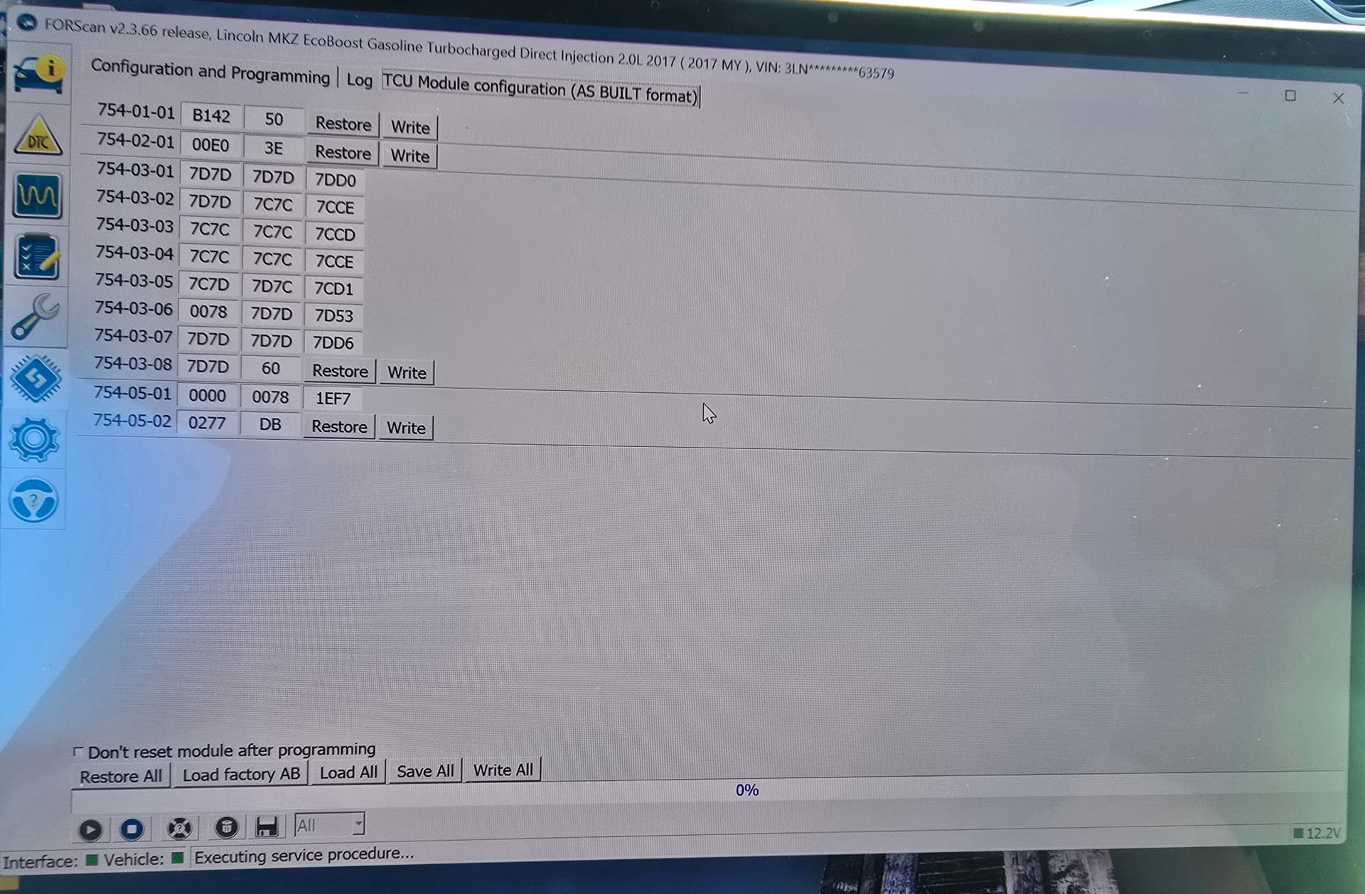

@F150Chief Im having issues on updating the tcu.
So here’s what I have going on:
I have the HJ5T-14G087-U model TCU installed into my vehicle with the original vehicle antenna, and a battery charger on the battery. Using OBDlink EX to my computer.
When I pull up forscan it shows the new TCU, but when I go to the “Configuration & programming” tab, the tcu does not show a update option. Am I missing some steps here?
Photos of what Im seeing:
You using Forscan 2.3 which cannot upgrade Calibrations. You need version 2.4 with a paid subscription.

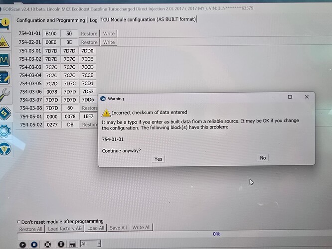

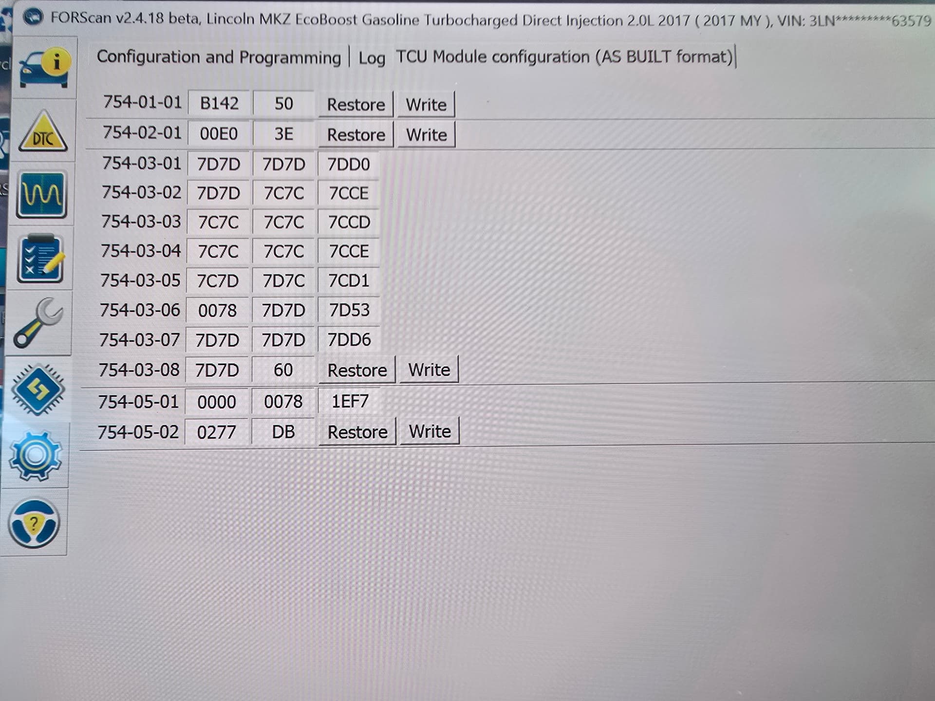

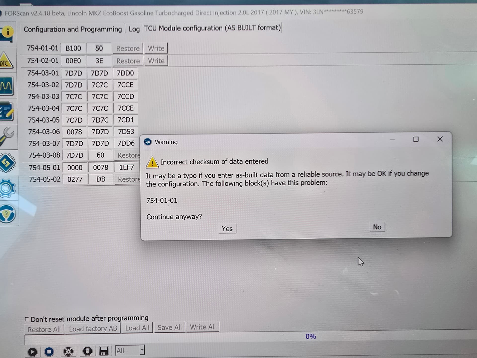

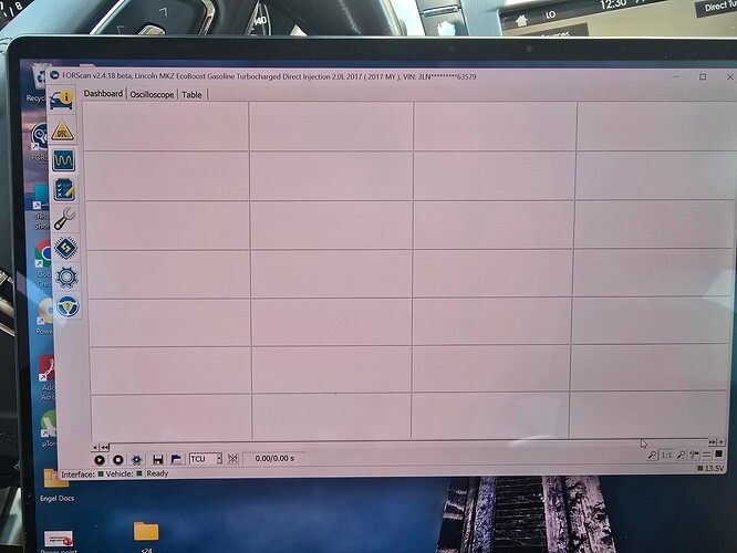

Okay I have the correct forscan app now. I downloaded and installed the UM firmware. Now when I go to Read PID Data, nothing displays. I tried going to the AS BUILT format to put the B100 on the top left, but it fails to write it each time. What should I do to resolve this? Sorry for so many questions. Photos attached for reference
When you go to read the data you have to press the play button in the bottom left to start the data stream. Nothing shows till you start that.
Continue through the Checksum error. it will calculate that automatically.
@bill32399

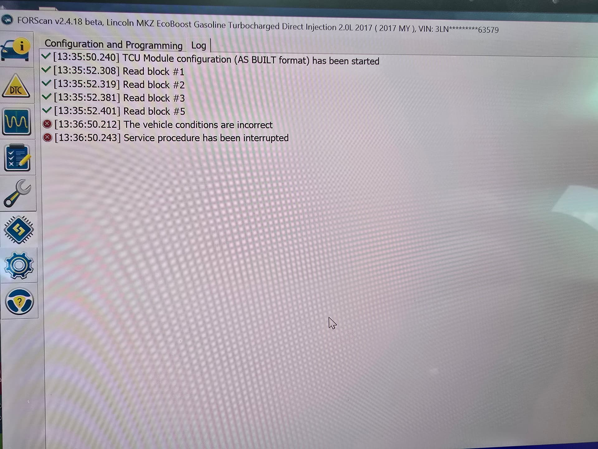

I tried pressing the play button to start the data stream, but the play button is greyed out. So it wouldn’t allow me to click start.
I did continue through the check sum, but it kept stopping, going to this page and giving me this error.
During the activation process the vehicle needs to be running.

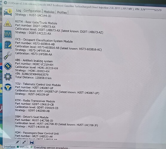

Does the APIM show the TCU SN?
Looks like the TCU firmware is ok.
Set the 754-01-01 back to B132 xx.
Then start the activation procedure with the engine running.
